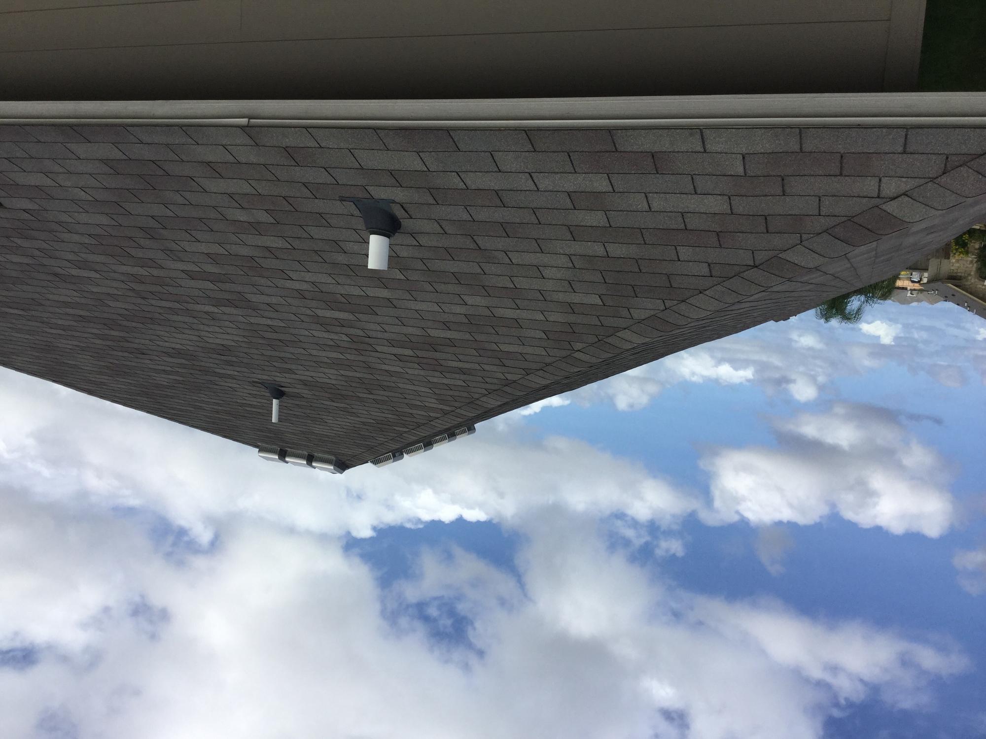

In the home in the photo it is my opinion that the attic is improperly ventilated. The roof covers an area almost 2000 sq ft and has a cluster of 7 passive vents at the rear 3rd of the home and a gable vent above the garage, there are continuous soffit vents, however with approximately 1/3 of the attic space not vented through the roof inadequate air movement may be an issue.

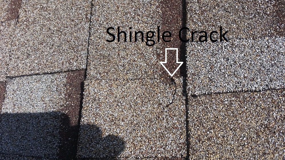

While performing a roof inspection, found a broken shingle at the ridge that left wood exposed. This is an area that water penetration will almost definately happen. Should be repaired properly.

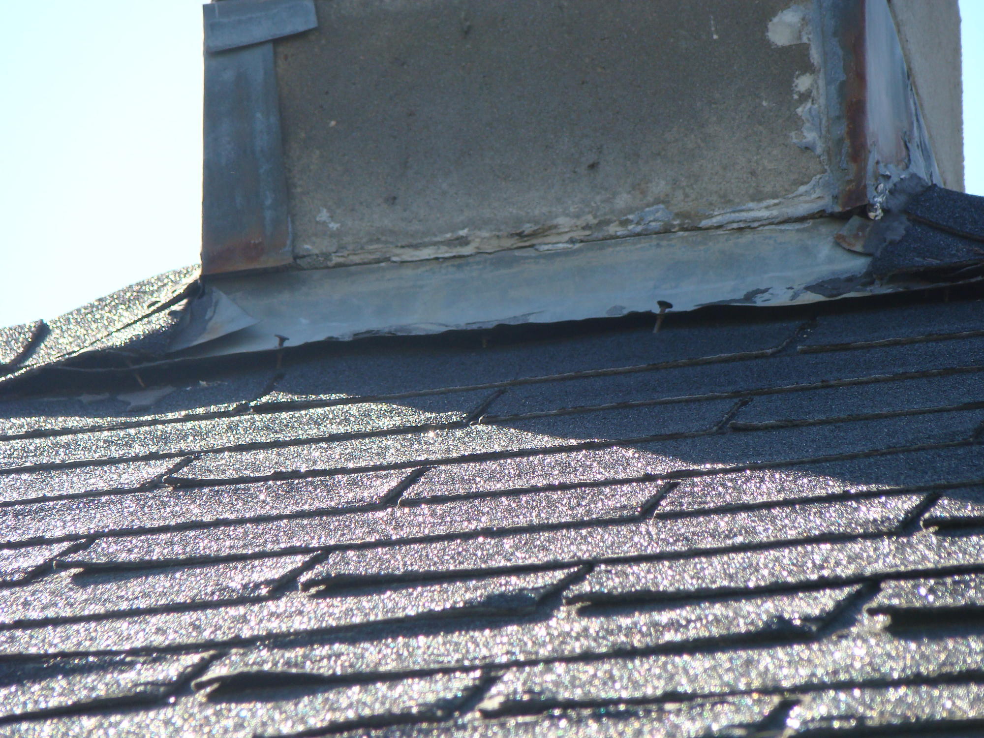

the photo shows a apron flashing in a chimney which is separated from asphalt shingle roof, nails have been pulled up. counter flashing rusted and sealant between the flashing and chimney deteriorated. I recommend a qualified contractor to evaluate and repair as needed.
