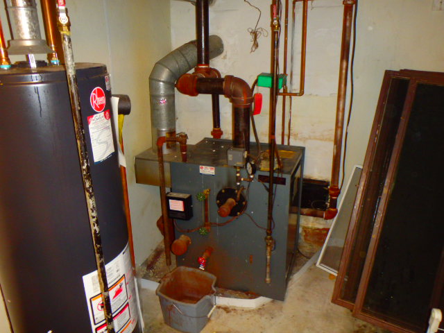

I love how they ran they system around the old boiler!!:roll:

Oh, lets burn the *** out of the panels with the hot boiler flue. Dumb ****.

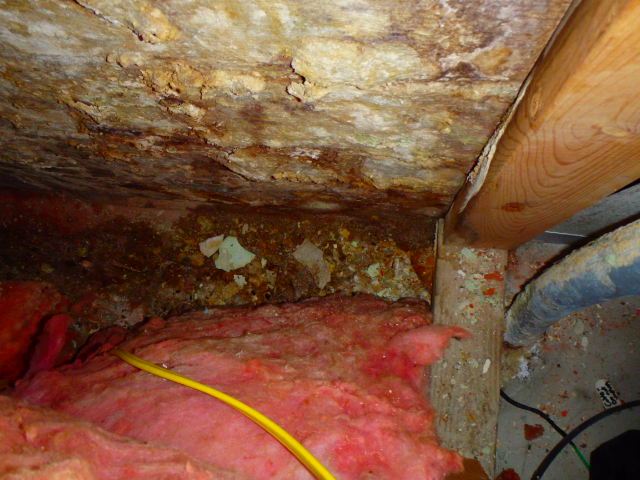

NO systems here, just some water intrusion, mold.

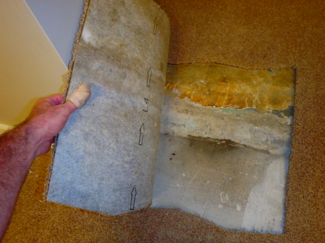

Lets finish the basement because we have a lifetime warranty **** ME.
How about some mold, nice carpet install.

Great photos. Did you use a boroscope for those shots? I ask that question because I just got my new one in last week that records great photos and video. Excited to start using it and adding to what I can offer.
No, just my camera inside the cavities. I have a boroscope sitting in its case.

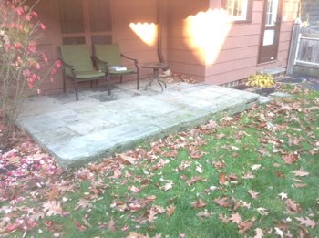

If we fix the adjacent patio and drainage we would divert a lot of water away.
