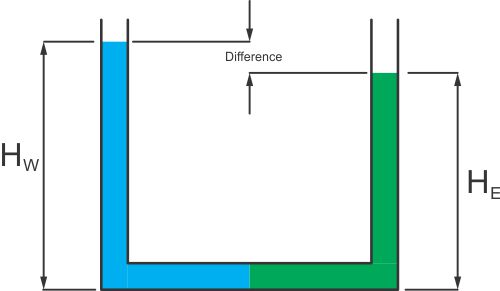

Upon completion of a bottom of a 2 storey garage and employing a water line hose (5/16" I.D. clear hose) to ensure level accuracy however the outside temperature was approx. -5 degree C. therefore I used a bit of glycol car antifreeze mixed with the water and the water glycol mix did not balance out… Weird. A 5/16" I.D. 35’ long hose filled with water/glycol and holding the two ends together and all the air was out and it was almost an inch different from the other. What the heck?](*,)
I found this out after the walls were built on a somewhat uneven foundation so each stud had to be ‘custom cut’ and now the building is out of level 13/16" over 32 feet. Is this within a tolerance? should I adjust each stud/jackstud over the the three 32’ walls before I continue with the top floor? Or should I leave it and go with it? What would a normal person do?

The difference in reading is due to a non-uniform mixture of ethylene glycol and water. Pure ethylene glycol is 12% heaver than water. If you were to pour pure ethylene glycol in one end and pure water in the other end as shown in the drawing the difference in reading will be 12% of the height measured. The more uniform the mix the less the difference will be. It would be very difficult to get a perfectly uniform mixture. Its best to use one type of liquid, I suggest using rubbing alcohol in lieu of water if you need some antifreeze protection.
