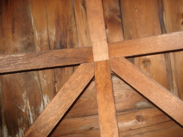

Ya wanna see something pretty???
Here tis.
Very nice joinery…I hope they get the decay issues resolved before this work is greatly affected.
