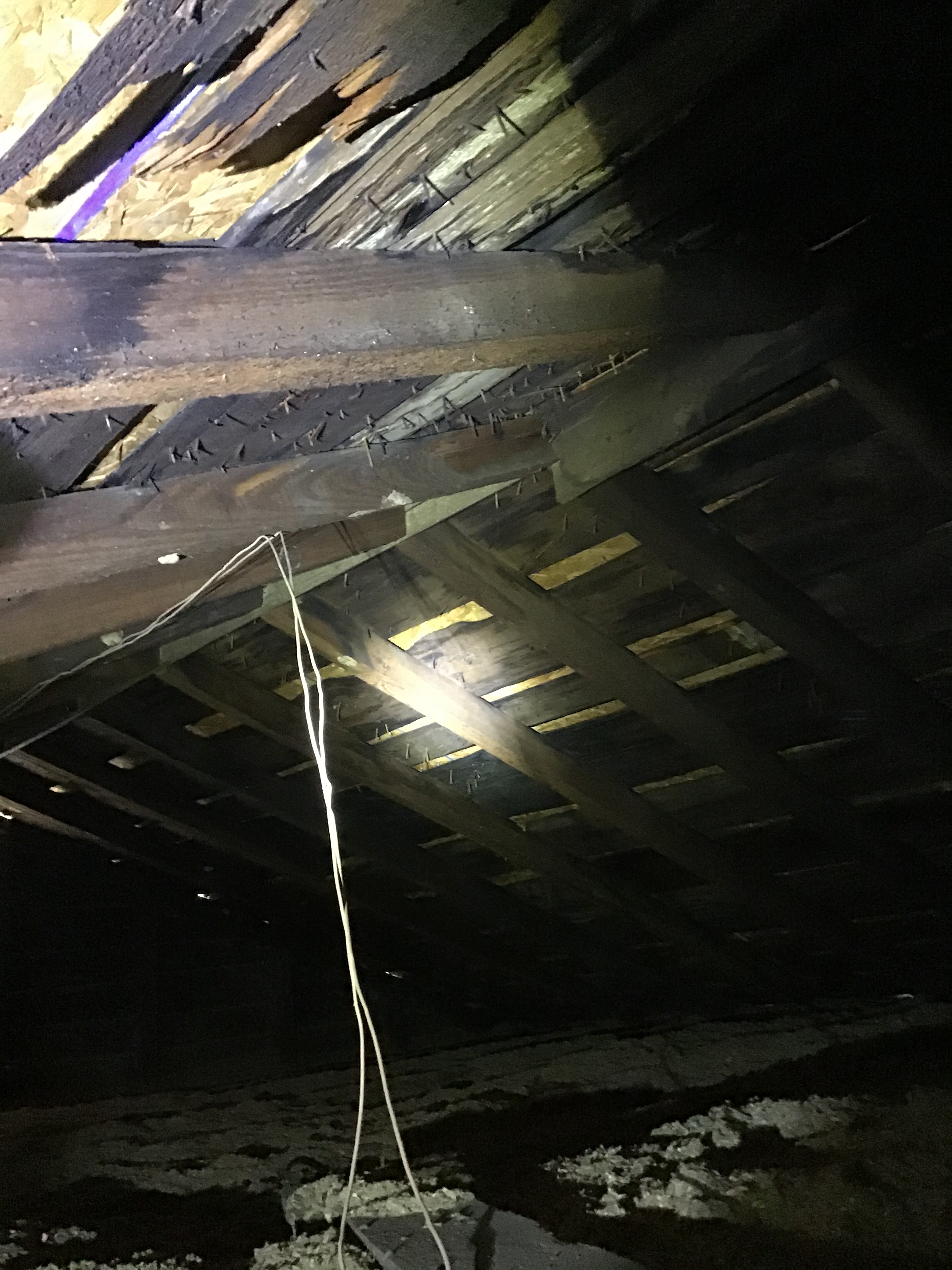

From the exterior, the roof had some odd waves in it. Architectural shingles look relatively new, but the valleys were an attempt at a weave. Noticed some OSB overhanging the edge of the roof and a mess where the original home met the additional. I was able to work my way far enough through the access point to see the roof decking. What are your thoughts?

My apologies for making it seem like I was looking for someone to write it up for me. I’ve already sent the report, and was posting here to share some experience with a nearly 2 century old home. To summarize:
Architectural shingles are attempted to be woven.
OSB laid over existing planking makes for an unsuitable base for roofing
The use of rolled roofing along a valley along with plenty of metal and tar flashing isn’t the best choice.
OSB is exposed at rake edges and is soaking up moisture.

Probably would of made out better with a standing seam metal roof. We have alot of those around here with the original skip plank sheathing.
