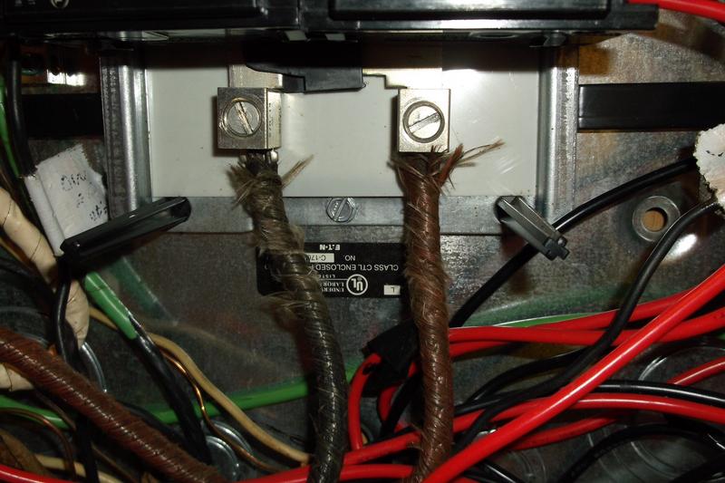

1956 built home. Cloth covered wiring?
This home has a new 200 amp circuit breaker panel that was installed within the past 10 years. The old fuse panel was replaced with a 60 amp sub panel.
The wiring that feeds the sub appears to be the original (cloth covered wire?)
Is there any issue with this wiring at this point as to what is visible in the photo attached?
2 story home on wood pilings. 200 amp panel - approx. 10 yrs. old is downstairs and the 60 amp sub panel is in the location of the old fuse panel upstairs.
Thanks in advance.
Unless the insulation has somehow been compromised then it’s code compliant to reuse the old rubber insulated conductors.

thanks for the comments
I was just making sure if it needed to be called out or not.
58 year old wire, but it still appears in ok condition - or at least at the panel connection main lugs
