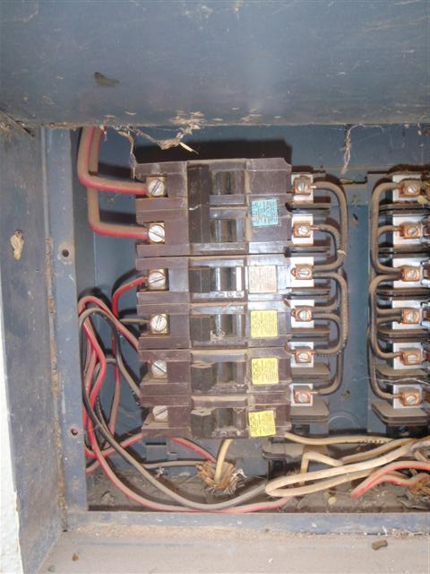

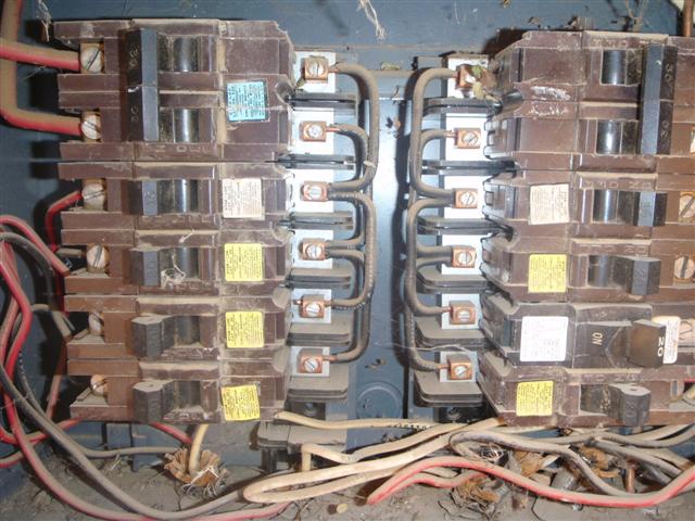

1957 FPE Panel
Just thought it was interesting. I’ve never seen one wired quite like this. It’s a parallel service for a duplex.

Hi Jeff,
I’m dying to know, did you call out the line side double taps? :wink:
Regards
Gerry
In this case, no. It’s actually a single conductor, looped at each lug. I did, however, recommend replacing the panel due to its age and low service capacity. It only has 30 amps to each side. . .
Hi Jeff,
thanks for posting that one, I too have never seen one quite like it.
Regards
Gerry
