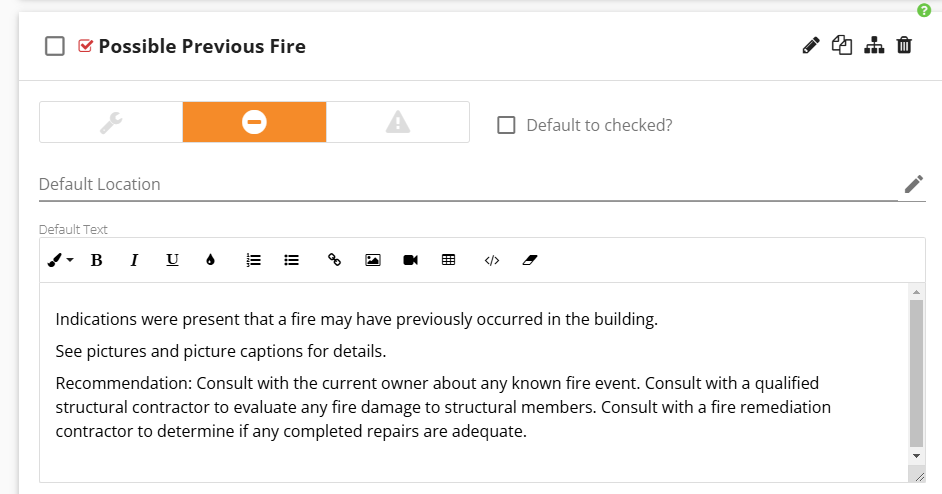

1st time seeing this- charred wood
I’m a little at loss on how to write this up.
At first I thought it was organic growth and they tried to hide it with paint, but then probed the wood and realized it was burnt. and could scrap it with a screw driver to get some char off. looks like it was all surface burnt and nothing deep *if that makes sense.
I’m assuming it was prior to the furnace upgrade *1972 toridheet unit.
built in 1922. looks like way back in the day they painted it with: Intumescent paint. owner dont know anything about any past fires.
Here’s my narrative when I find previous fire damage. Hope it helps!
Ryan has a good narrative, and here is why- a professional analysis is needed to determine the viability of the charred lumber.
used that image in my report. . … and i think Ryan got my basses covered.
