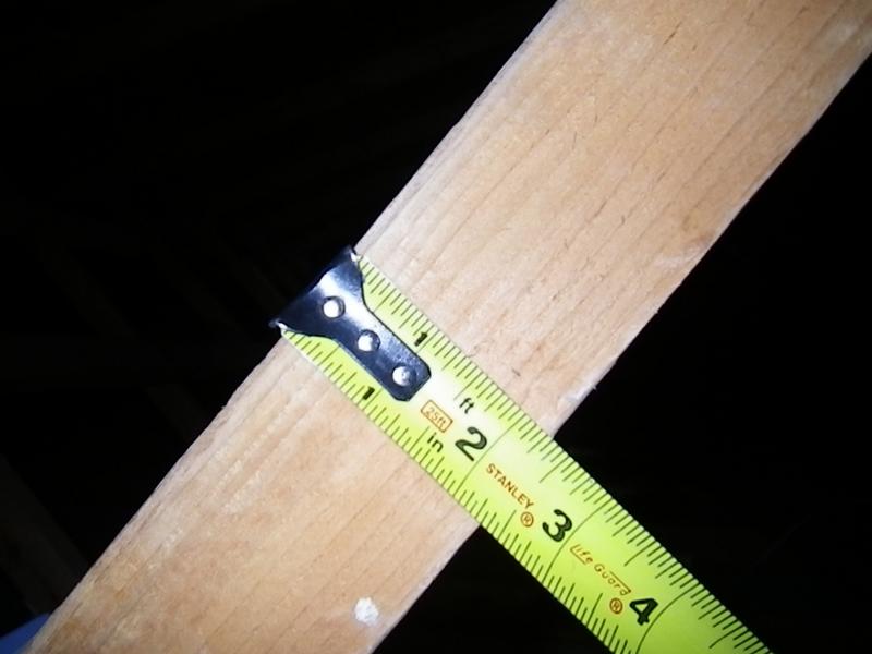

I inspected a house yesterday built in 1993. It was a single story gable roof with concrete tiles. The house is in Chandler. Above the garage all the engineered wood trusses were 2 5/16" by 1". There was no ventilation in the garage attic.
The agent is a structural engineer that I worked with in a past life. He states that structurally there is no issue. I verbally mentioned it to the client (electrical engineer) and called out the lack of ventilation in the report.
I see that in modular homes.
Manufactured homes as well.
I remember building homes in the late 70’s with 2x3 interior walls and 2x2 partitions in selected areas… I am not surprised by the truss.
