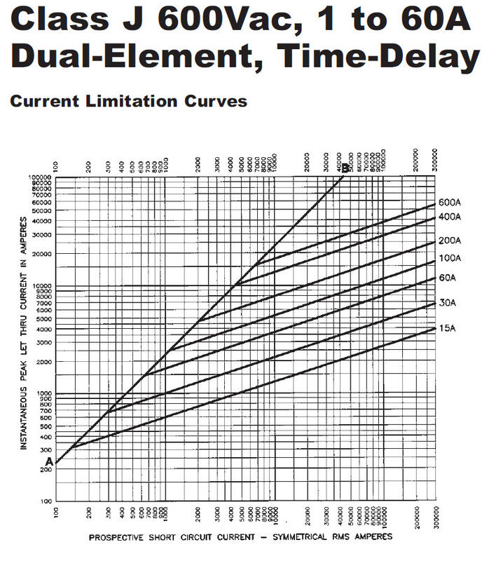

There are ways to limit let-through current but they would not generally apply to residential systems. There are special fuse classes that specifically limit the let-through current. I have attached a chart for a Class J fuse as an example for the benefit of those who may be interested.
The video you posted, while impressive, does not address the questions posed by Juan. I was addressing Juan’s questions. Had there been a Class J or a Class L fuse, for example (or, depending on the AFC, perhaps a K1 or K5, etc.), the fault would have cleared without incident. In fact, Bussman has a whole series of videos that demonstrate exactly what I am saying. In one instance, they will use an improper class device and then they will show the same thing with the proper class device. In the first instance, there is an explosion and in the second, there is not. They go a step further and show both in extreme slow motion. In the second instance (the one with the correct class device), the cable starts to form into a circle then relaxes. At normal speed, the movement cannot even be detected.
So, going back to Juan’s orignal question, the current during a fault WILL rise to a level many times greater than the circuit breaker’s overcurrent rating. The breaker does NOT prevent the rise in current. The conductors will not vaporize. The equipment will not be damaged. Unless - there is a defective or damaged component or the system was not properly designed and installed.

I will not be drawn into strawman arguments. I posted the chart for the benefit of anyone who may be interested and may not have known or believed that current flow during a fault is very high.
When you added the impedance of the tranny to the equation I included the effect of the same ground fault between the tranny and the first overcurrent device.
We are both addressing issues in the grounding and bonding of an electrical system.
I like the chart you posted for the let through for a 600 volt time delay fuse, but, we are discussing a 120 volt circuit using an inverse time circuit breaker. As a general rule of thumb multiplying the rating on the handle by 6 will give the amperage it will take to open it within a two cycle period, .033 seconds (magnetic trip). Most inverse circuit breakers will hold 135% of their rating for two hours before opening (thermal trip).
If we look at the chart you posted we can see if we were using a 600 volt 15 amp time delay fuse that the fuse would open instantaneously at around 1250 amps. You are correct that a 14 AWG copper conductor would not sustain damage in this fault. The peak temperature on the conductor would be even less on a 120 volt circuit protected with a 15 amp inverse time circuit breaker.
