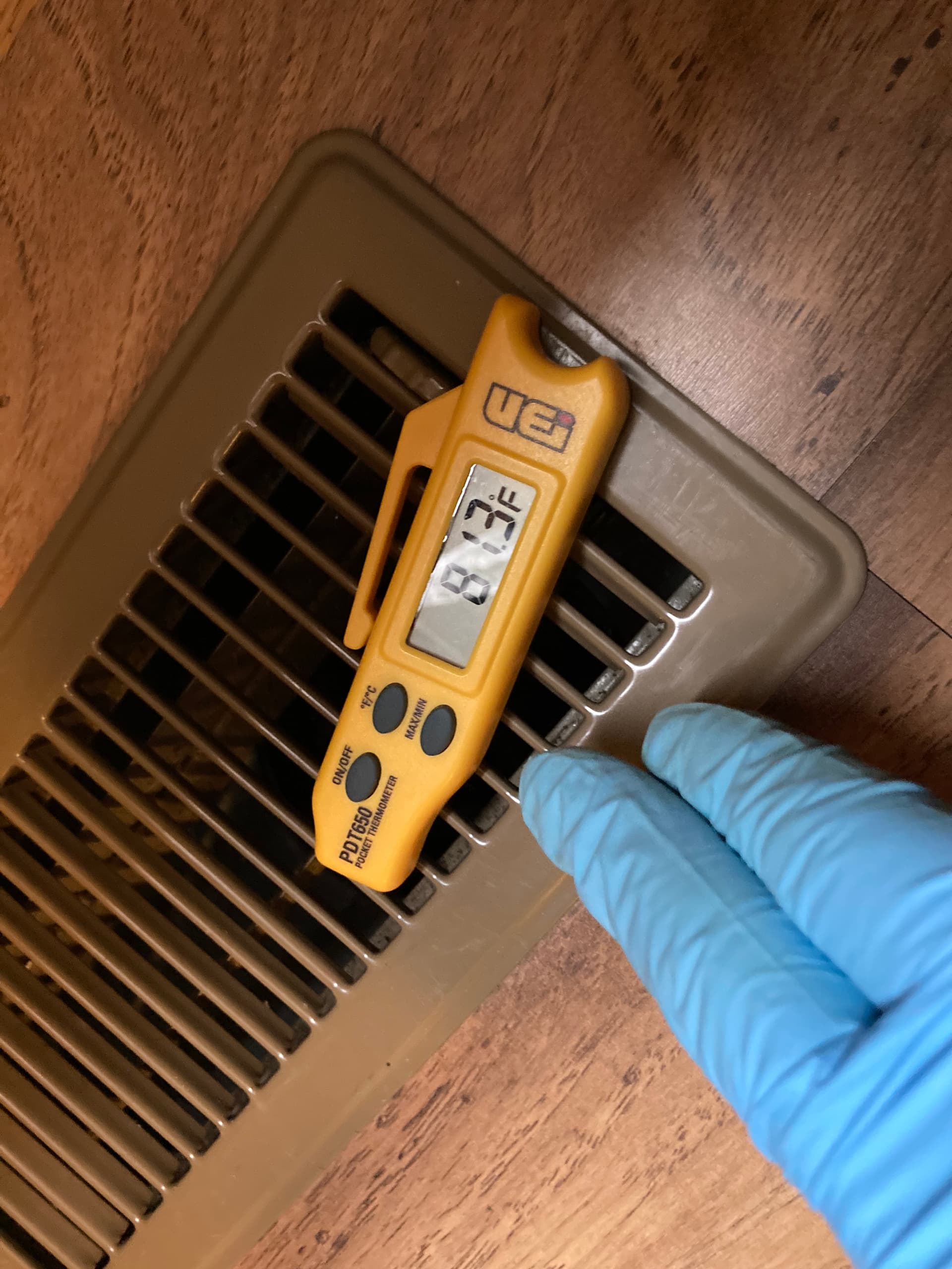

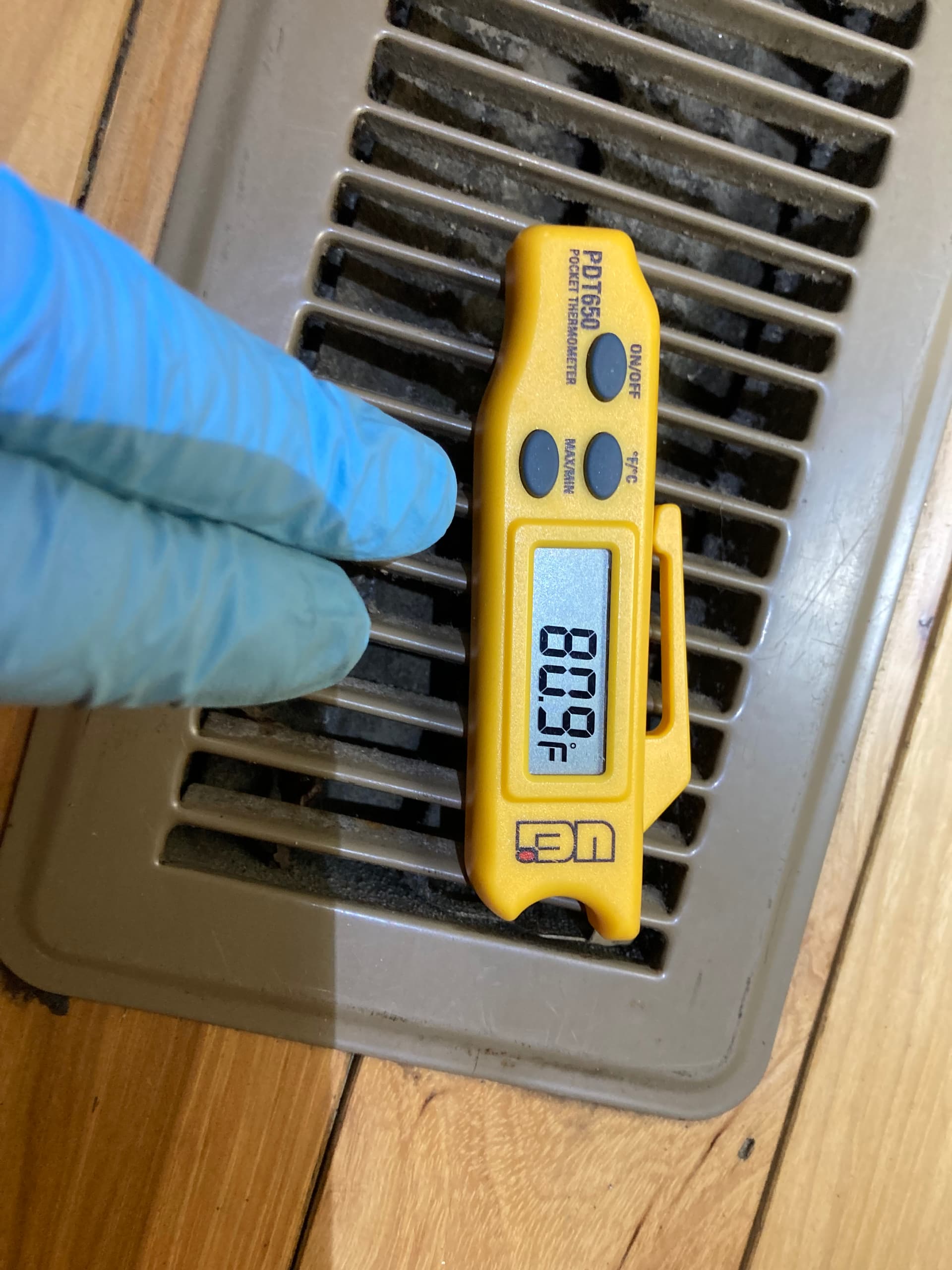

and then warmed up to 123 degrees as measured at the registers.
I was about to report it as a defect…but then just happened to recheck towards the end of the inspection
but literally for over an hour it was blowing at 80 degrees
ambient temps were around 45 degrees outside
This is not something I’ve experienced before. The unit appeared to be well cared for, the evap coils and coils at the compressor were clean as were all filters.

Is this an all electric HP?
You can do an amp draw when the heat strips kick in if you want to confirm they’re functional.

Measuring the temperature of air at the registers is always deceptive. The goal is to bring the ROOM temperature up to the thermostat setting. Register air quickly dissipates and cools as it mixes with cooler air in the room. A Home Inspector needs to check that each habitable room has a heat source and that it operates (supplies warm air). Any attempt to measure the temperature or efficiency of the heating or cooling will be misleading, time consuming and way beyond the standards.

At 80 degrees, I would call it out.

Call it out. You have an airflow problem.
I see that filter crap inside the registers. Not helping. A furnace is not an air cleaner. They probibly have high density return filters as well.
Let the HVAC guy yell at them…

thanks guys
I did call it out in the report already
I was worried that I had misdiagnosed and called out something that shouldnt have been.
but guess I knew there was an issue as I do that temp test every day , and this one was low
