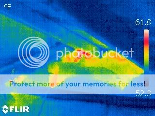

A few years prior to our retrofit work, the owner had ripped out, re-wired, insulated, etc and installed a new kitchen in the rear addition. I had this scanned since it was a small area. The insulation work done by the owner was actually pretty bad to the point that he said he should have consulted with or hired us to do the fiberglass batt & air/vapour barrier work when he did the renovation!!
Not so good insulation install. Batt insulation with gaps
