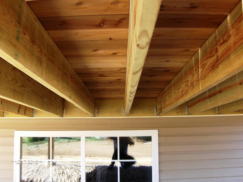

Does anyone have a copy or can cite from CABO when deck bolts were required. I know I was installing them in the 80’s…thanks.

I appreciate the response guys but I know how to build decks… I am looking for an old BOCA reference… once the ICC took over in 2000 I threw my BOCA NC residential book away and I wanted to reference same to my client whose seller is stating that they were not required at the time the home was built. I spoke with one of the AHJ whom I have worked with over the last 15 years…he said it was in there but he too no longer has his BOCA book but validated that it has been required for at least 15 years…at least in my county.

P6100010.JPG:slight_smile:
These are allowed by local AHJ.
Pretty lienient code enforcement in your area huh!:mrgreen:
Apparently in this particular town. I did get them to add more, they were at minimum 48" center. It was only a $400,000 house, new construction, what do you expect. :stuck_out_tongue:
:shock:
They didn’t like “wasting” fasteners for hangers at joist either, pic. 3. :wink:
It sure makes me wonder on where they learned to build things. :):roll:
I do not see the bolts staggered 16" o.c. every other on the ledger either in picture 4. I am wrong. Look at picture 4 I see a pattern far right then nothing for well over 24" inches. Not just the type but appears not even close to enough…
It looks like white wood, Marcel…
No, it wasn’t Larry. Just a camera lighting. HD or Lo PT. lumber. :slight_smile:
10-4, my friend. :smiley:

The home owner was an engineer…when he got hold of the report he was not happy. The main contention was the deck and roof over the deck. Common sinkers were used to build the deck and improper ventilation of the roof resulted in over 100 nails backing out due to thermal expansion and contraction. The deck bolts were a side issue. I have been building homes in NC since the early 90’s and every county I have built has required bolts… when the ICC came out I discarded my BOCA book and other requirements held by local surrounding counties.
