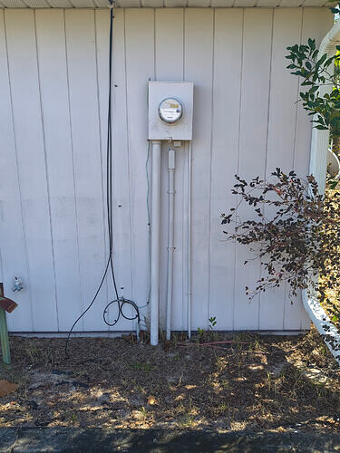

**Post date:** [January 25, 2026, 7:23pm UTC](https://forum.nachi.org/t/70-amps-electric-box/264439/10 "2026-01-25T19:23:26Z")
</div>
![image](https://global.discourse-cdn.com/internachi/original/4X/7/a/e/7ae73f07f5232fef9e5177a004e30654a6ca5fa2.jpeg)
That’s not the Main Disconnect..
Also…
> [@jdiazvelazquez](#):
> I did Inspection at **mobile home**
Please _elaborate_!!

That’s the meter box. You do not disconnect service by taking the meter off.
The two breakers highlighted below are your disconnects. The circled breaker turns off all the breakers below.
 ![IMG_1878](https://global.discourse-cdn.com/internachi/original/4X/4/0/e/40ea72a8ee4c3cd15b56232ece9badef36772d0c.jpeg)

Yes but is not another one
<div class="post-metadata">
**Author:** ![jdiazvelazquez](https://sea2.discourse-cdn.com/internachi/user_avatar/forum.nachi.org/jdiazvelazquez/32/405525_2.png) [@jdiazvelazquez](https://forum.nachi.org/u/jdiazvelazquez)\
**Post date:** [January 25, 2026, 9:19pm UTC](https://forum.nachi.org/t/70-amps-electric-box/264439/13 "2026-01-25T21:19:22Z")
</div>
I know but that’s the only two
**Post date:** [January 25, 2026, 9:23pm UTC](https://forum.nachi.org/t/70-amps-electric-box/264439/14 "2026-01-25T21:23:07Z")
</div>
So the 50 and the 70 are the amps for the house

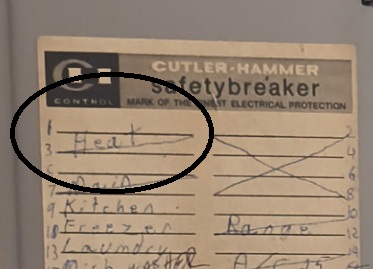

The 50 is for “Heat”
 ![Screenshot 2026-01-25 145828](https://global.discourse-cdn.com/internachi/original/4X/0/d/b/0db8ea96bfd2d39d2f57794ba6633eaf9d288c06.jpeg)

Was that meter attached to the exterior wall of the same building that the Cutler Hammer panel was inside of?
Did you look behind the wall that the meter was attached to to see if there was a second panel?
The main service disconnect in that backfed Cutler Hammer panel appears to be missing a fastener to keep it from accidentally being removed from the bus bar.

> You most likely failed to inspect the panel located on a pedestal or pole at the exterior of the home…
I’m not sure I agree with this. Why would there have to be another disconnect upstream of this panel? If there were another one, I would expect to see ground/neutrals separated in this panel (in most cases). Also, this panel is clearly older than the requirement for an exterior disconnect..

Mobile (manufactured) homes usually have a main service disconnect or electrical service disconnect at the exterior of the home where I live in Colorado. The photo of that meter on the wall does not resemble a manufactured home. There’s more to the story that we’re not getting from Jesus.
