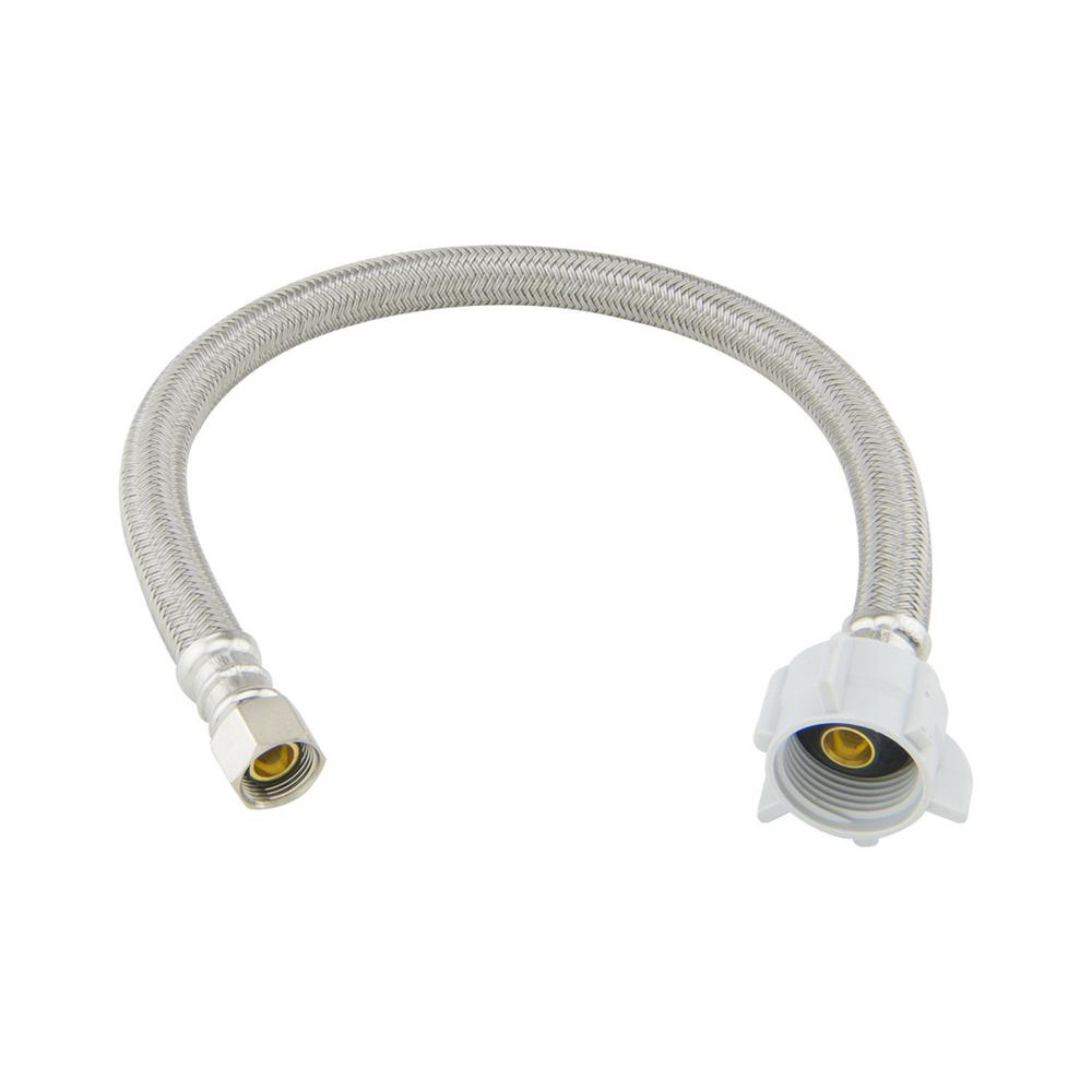

I think we are talking about two different animals. You are talking about this;
 ![silver-brasscraft-supply-lines-b1-16dl-f-64_1000](https://global.discourse-cdn.com/internachi/original/3X/2/f/2f4ab50eb4722b409800042b5bd7b3a3a7a0af6d.jpeg)
and I am talking about this type;
 ![820633969389](https://global.discourse-cdn.com/internachi/original/3X/4/0/40137fda143a22bb9cc905258d79b9dfc44d6c3d.webp)
There is a big difference in quality here.
