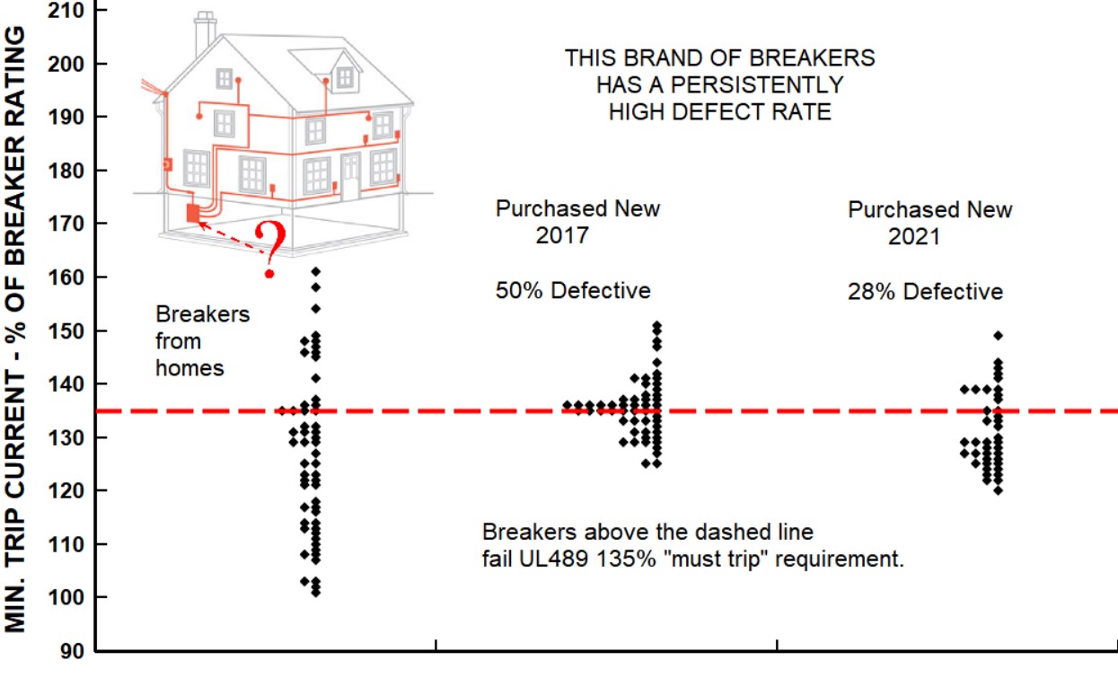

Are FPE breakers a defect?
A report filed in 1982 with the Securities Exchange Commission (SEC) by the parent company of Brand X states that the manufacturer had obtained its NRTL listings by “… deceptive and improper practices,” and states that most of the company’s circuit protective products lost their NRTL listing after the improper practices were discontinued [18]. That report, submitted to the SEC more than 2 years after the deceit was first revealed, also states that, “The company is in the process of correcting product deficiencies in order to regain the lost listings….” Clearly, the breaker design and manufacturing problems that had to be solved to comply with the UL489 requirements were not trivial.
Source
The estimated cumulative total fire losses since the brand’s performance problems became known is about equal to the 40-year sum of the annual losses previously noted. The result is more than 100 000 residential fires associated with the defective performance of the Brand X breakers during that time, with at least 500 fatalities, 4000 injuries, and $1.6 billion in property damage.
