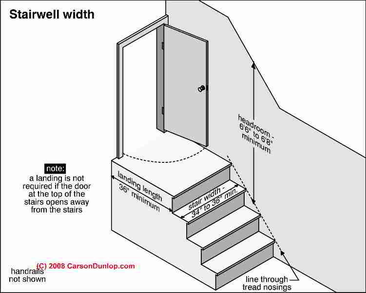

Hi Rick, I agree with you that many of these items are covered by the courses I am currently taking through Nachi’s educational curriculum. the reason I am asking them is because I have come across other sources of information which diverge from what I have learned through Nachi. I am just trying to find out the reason behind why there would be two different answers for questions that seems could only have one answer. for example, I had someone tell me today that it is not required to remove the dead front from a service panel. up until now I have always been under the impression that there would be no way to determine what the heck is happening in the panel unless you remove the dead front. However it was told to me with certainty by someone who has done many inspections that the dead front does not need to be removed when doing four point inspections. So,I thought just to get a general consensus I would ask that question. I have a 90 certainty that the panel needs to be removed however the question is worth asking anyway from my point of view.
in regards to the question of the landing dimensions of a door that swings out over a landing, what I have learned from this website is that the dimensions need to be 36 inches by 36 inches. However, it was explained to me repeatedly that need that needs to be 42 inches. this is an area that would seem to be fairly black and white yet when a seasoned inspector tells you the anything less than 42 inches needs to be written up yet all of the documentation that I can find on this website points to a 36 inch depth I figure it might help to ask for consensus rather than just go on not knowing.
I would feel like an \*\*\*\*\* calling out something on an inspection if it was perfectly fine to begin with. All I am doing here is trying to establish a baseline for my knowledge so that I can begin with solid basics.

I believe an out swing door would generally be 36" wide as a means of entry or egress. The minimum dimensions would need to be the width of the door in the event
there were a guard rail or step in the path of entry. That being said the width dimension should be a minimum of 42- 48" in the event one of the treads of any stairs were incorporated into the landing.
You state you are being told by someone otherwise. I say consider the source as it might be an opinion you are getting. These issues are not subjective in nature. Try practicing on [Reporthost.com](http://Reporthost.com) where you will find a great many narratives that will address some of these questions in a more specific manner. It’s free for the first fifteen reports and unlimited to practice.

For example, this would seem to point to a 36" depth incorporating the top step.

Yes minimum dimension(s). So here is a scenario. You have rails and guard railing installed at the landing because it’s over 30" above the floor below. Let’s assume its a garage. You are carrying groceries up and opening a 36" door into yourself on the stairs and you have no room to place things down on the landing. In this case a larger landing platform would be a consideration and yes 36" is all that is required but is it practical and safe…? A 48"x48" landing would be what I would consider minimum with stair tread width not necessarily needing to be that wide. If the door in your diagram were 36" wide it would be impractical to open.

> Over 72" requires a 42" guardrail.
> Stairs are required to have a handrail if over three rises. The railing needs to be between 32" and 36" high.
This must be a Canadian thing. In the US, It’s =\> 30" above grade for required 36" high guard (residential), 42" high for commercial / multi-family. Doesn’t matter how high above grade if over 30" for guard height.
