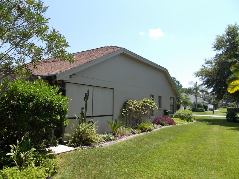

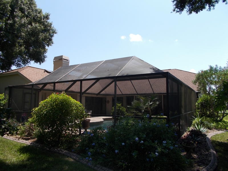

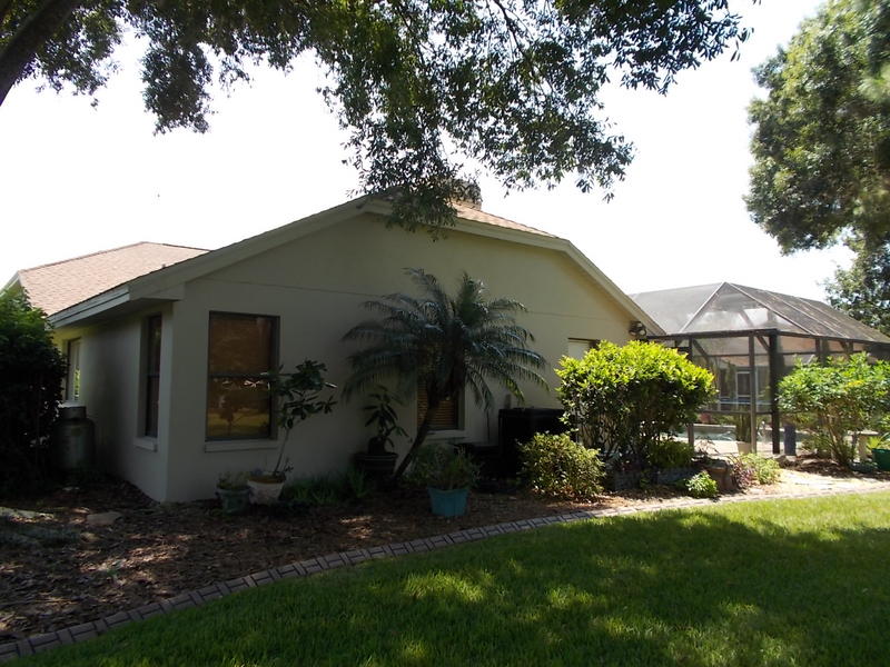

I have attached the photos I took from the inspection today as well as put a layout in the file identifying the location and length of each gable.
The roof geometry was not the only issue.
The SWR peel N Stick was never verified by the previous inspector and I observed only standard roofing felt when looking between the joints in the plywood decking.

Sorry the PDF file was too large. Here are the exterior photos that I took today. I will upload the attic photos and the layout I created in the next post
Here are the additional photos and the layout

Regardless of which form was used the roof geometry should have never been marked as “hip”
The entire left wall of the home is a gable as well as the entire back pop out wall.

Also, on your roof sketch, you are counting the entire clipped gable as non-hip. Only the raked sections of the gable count as non-hip. The overall looks like “Other” though.
