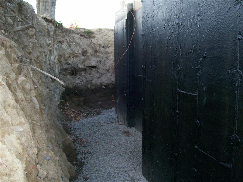

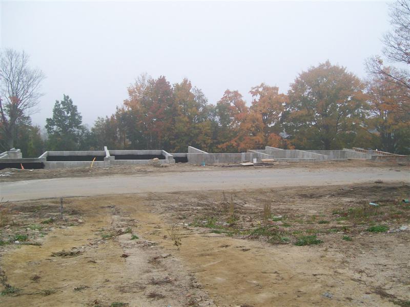

Finally the foundation is done. Need to finish the waterproofing before starting the perimeter drains.
This shows the mudsill shelf (inside) on the left unit (brick shelf in the foreground).
View of the back frost wall of the middle unit.
Birds eye view of the garage interior walls.
Parting wall between two units. This will have two 2 x 4 walls built on top with the 2 hr. fire rated shaft liner in between.
Front view of the 4 unit building. Nice views on a clear day.

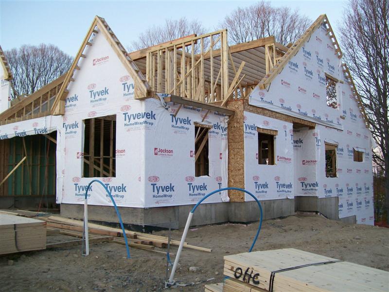

Framing update on the first building.
Front view, making progress, some rafters and second floor partitions up.
This is a typical 2 hr fire rated parting wall, 2 pieces of 1" shaft linerin aluminum track.

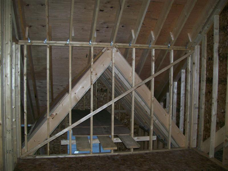

Different views of the construction of a dormer.

To answer your question Marcel, once the hole is ready we have the surveyors come in and actually layout the building with stakes &/or re-bar pins. This way the form guys shouldn’t have any questions. Then once the footings are poured the surveyors come back and they’ll pin the footings (survey nails in the corners). The architect has all the elevations for the footings, slab, top of foundation, brick shelf, etc. labeled on the plans. He sends that info to the engineers who calculate the coordinates and then sends the surveyors out to stake / pin the hole for us.
It keeps my behind out of the frying pan, if you know what I mean! Only made that mistake once and we had to get a variance for 6 inches of a 10’ section of a house that was outside the building envelope.
I’ll take some pics in the morning and post them tomorrow.

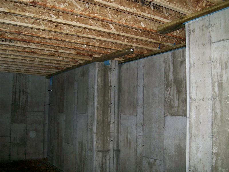

This is how the joist shelf looks completed (check out ist pic in reply #21, the before pic). We did it this way to keep the height of the first floor lower, which in turns allows us to only have 2 steps out the door to grade (over age 55 subdivision).

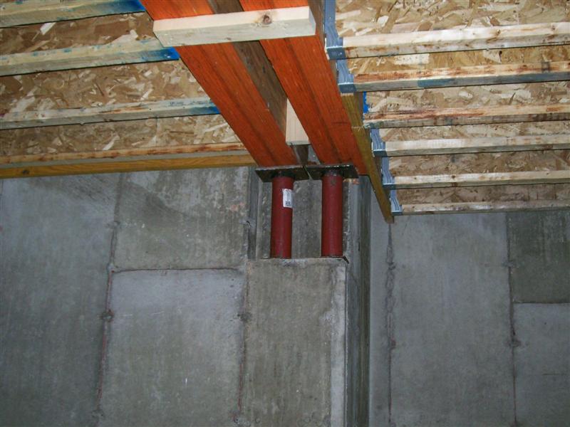

support beams and columns for an A & B unit.

1st building update continues.
Window header for a triple mullion on the back exterior wall of the lower unit. Triple 2 x 10’s with 1/2" plywood sandwiched in between for a 2 x 6 wall.
View of the rear of the building. As you can see why the need for the microlam header listed above, there’s a lot of weight coming down for those big openings. The opening on the first floor is for 6’ sliders.
View of the two 1" shaft liners as part of the required 2hr fire rated parting wall dividing of the 2 units.

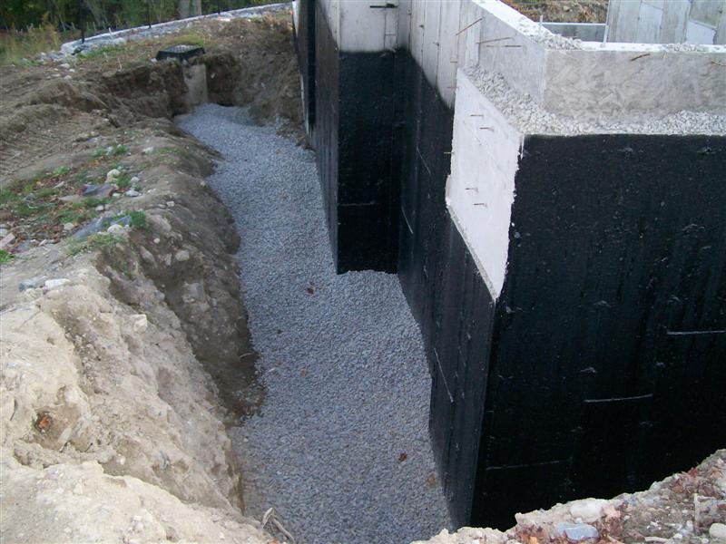

Update on the building awaiting the perimeter drain installation.
Perimeter drain pipe is in and covered with 3/4" crushed stone. The electrician likes us too, we’ve already installed one of their ground rods for them with the ground wire attached.

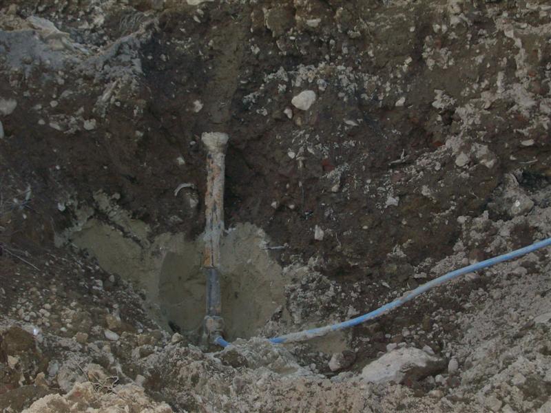

Found the curb box for the water service. While we’re here might as well get it connected before completely backfilling the foundation. But I think we need to add a couple extention pieces to get to grade (about another 3-5’ higher).
with this much stone there shouldn’t be any water issues:mrgreen:

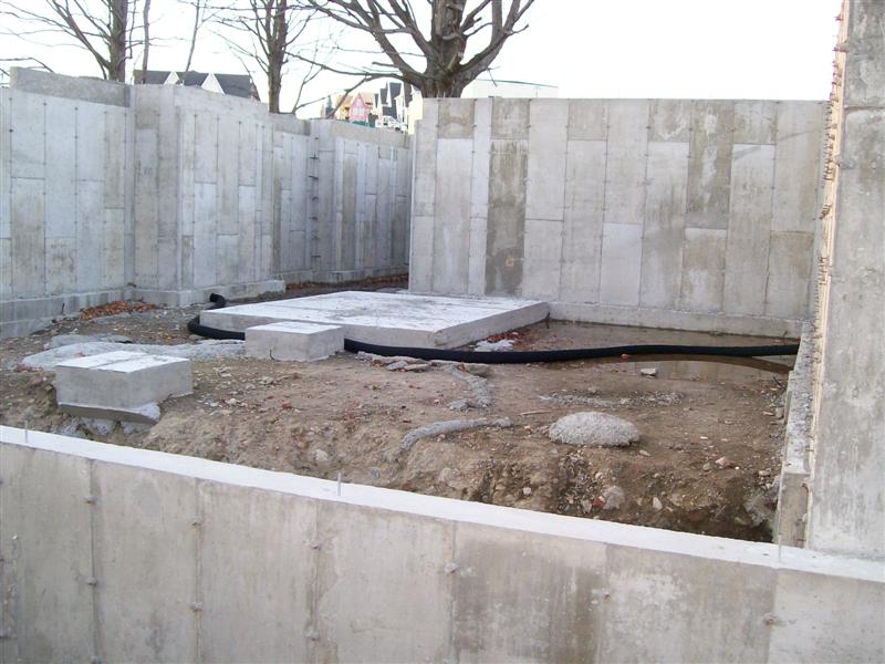

Under slab drain pipe install in each unit. Even though this building does not have a condo unit in the basement (like the other building), people have the option to have a finished basement (being it is a walk-out basement). An ounce of prevention is worth a pound of cure, it’s a lot cheaper to install the pipe now than try to fix something after it’s all finished.:wink:
As of yesterday 10/30/07 building inspector came out and gave us the thumbs up, go ahead and backfill.:smiley: That’s what we’ll be doing for the next week or so. Backfill the foundation, backfill and compact the inside the garages, stub out the sewer lines and backfill inside the basement areas. After all that is done, we’ll drop some lumber and start framing.

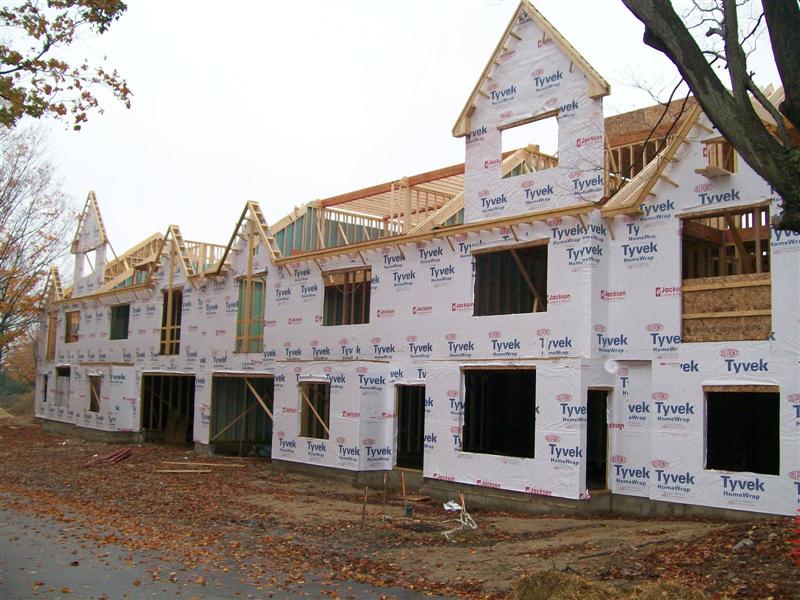

Some progress on this side of the building. We asked the framer to concentrate on the left half of the building where we have sales and one unit to be our model home. Per usual, the big push is on. This half needs to be completed by February (a lot of work to do and not much time, I hope this nice weather keeps up!)

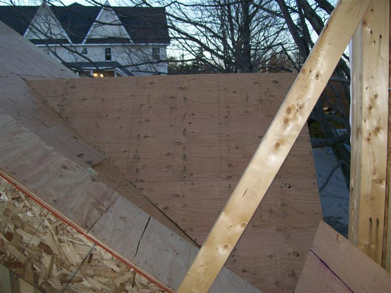

Sheathing on the roof. Roofer not far behind.
This gable end is done.

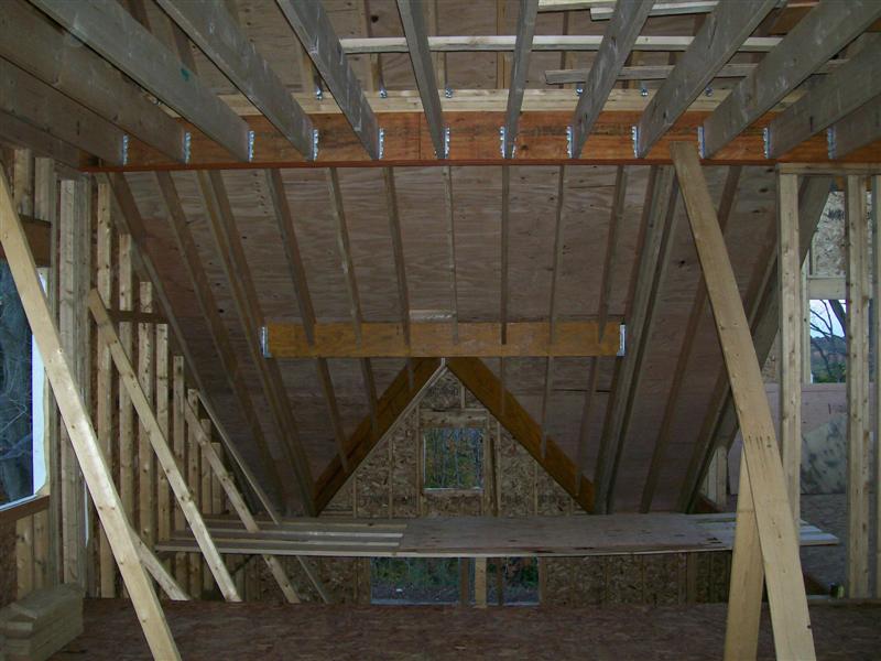

First building updates continued.
Pics of the back dormer (gable) completed with ceiling joists. When completed this will be the loft area with an open area overlooking the living room. The orange beam is supporting the ceiling as well as the roof load above. The rafters were cut and notched onto the beam above then secured with hurricane tie downs. The rafters were split due to the length of run, they would had to have been over 30’ long, this way it’s easier to handle, cost effective and just as strong.
Front gable for the cathedral ceiling for the eat-in dinning area as viewed from the loft area. The wall in the foreground will be sheetrocked, therefore it will be necessary to install “proper vent” (styrofoam channel vents) from the top plates of this wall, along the rafters to just beyond the ceiling joists to ensure adequate venting in the attic space above.
