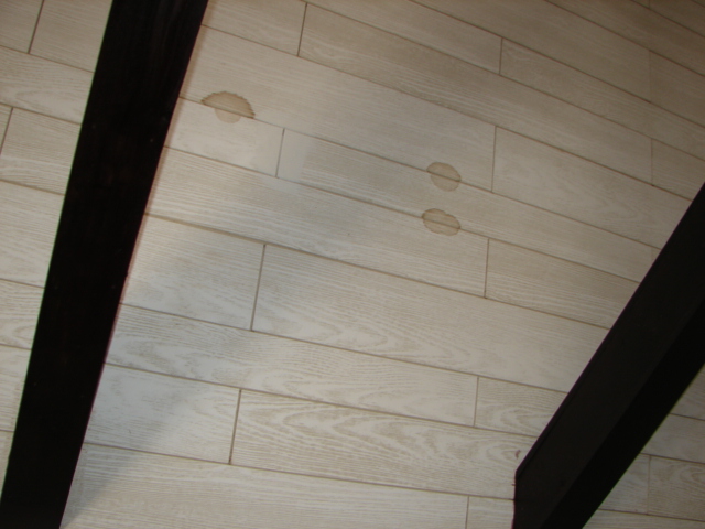

How much damage can be caused to a home vacant for the past 3 years (oh and the current owner knew the roof was bad.
Crawlspace wasn’t much better, and the “plumber” didn’t help the situation. Nevermind the Septic :roll:

By the looking at the photos I can only guess why the house has been vacant for three years…:shock:
Was there anything worth saving>?..:lol:
Toss in a couple interior pictures would you please, I have not seen anything that bad in quite some time…:lol:
Sorry Dale it was only a one hour Structural, no access to the attic and I was out of the main living space, I kept asking the client are you sure you don’t want the interior inspected? he wanted to stick with the $175.00 basement/attic (or lack there of) with report.
I’m kicking myself for not snapping more pics … picture brown carpeting, ivory painted walls all moisture stained with mold…oooops I mean "bio Growth galore. :neutral:
If the seller comes down $30,000 he will still think about buying it for a summer home.

Habitable before summer? ummmm a full crew working around the clock … if they don’t find much underlying damage … which I’m sure there is, I told him expect to replace the plumbing as well. It wasn’t winterized. :shock:
Current owner asked not to turn the heat (electric baseboard) or water on. I wonder why? :roll:

“Anything goes in the Poconos” … tomorrow should be interesting … guaranteed to be T-1-11 and a wet crawlspace,hopefully the septic system will be intact. :neutral:
I should of put $$ on my “guarantee prediction”
T-1-11 it was , Racing stripe (AKA thick)bead of caulking at every corner of the tub/shower - high levels of moisture found at all locations of interior walls (multiple settings)
Water in the basement you bet! Unfortunately this is a typical inspection in this county.
1200 sq. ft. 5 hour inspection 2 1/2 hr report.
