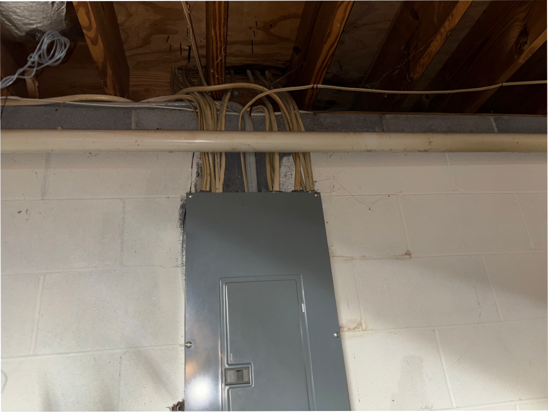

A well watered main panel
Bet you can’t guess what’s going on here. Clue, water dripping from the main panel.

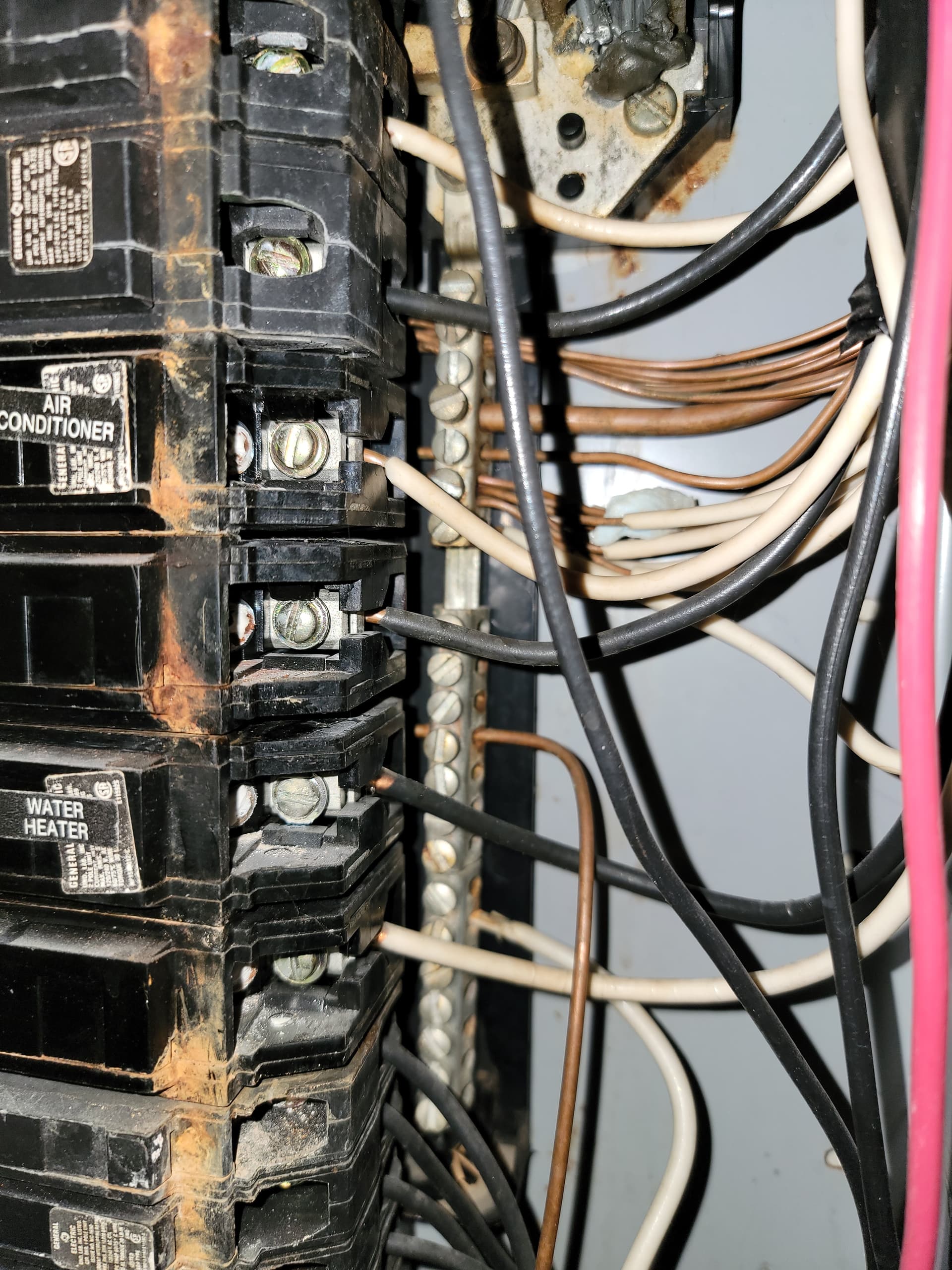

Nope, it’s not the waste pipe above the panel, it’s actually the water leaking down the wiring coming from the chimney chase area above. Do to the internal drip loops inside the main panel, none of the internal components were affected. Who says it doesn’t pay to inspect when it’s raining.
Usually it’s from an inadequate seal on top of the meter socket. Water will find it’s way inside the SEC insulation and then drip into the panel. I found this one yesterday.

I have to disagree with its a plumbing issue. You would observe this problem when you inspect the exterior and service coming into the bldg. I know if I called my plumbers to check this out, they would show up charge me a service fee and leave. This is an electrical problem from not sealing the service panel adequately with rubber seals, or bushings. This is a very unsafe situation. Just giving my opinion as I see it.

This house had an underground service lateral. Thermal imaging also revealed a leak in the room above the main panel. The leak was to the left of the fireplace at the edge of the chimney chase. I’m going back today to inspect the roof with the drone.
So this is not even an electrical issue. At least the panel or its components weren’t damaged.
Hey Robert, I suppose I should have entered this under Structure, perhaps. With the amount of water dripping through the panel I was surprised the internal components were ok.
It’s good in the electrical forum too because as you’ve mentioned this is something to look for when inspecting a panel. Looks like the water only dripped off of the conductors and never made it to the breakers or the bus bars.
It is a hybrid. The problem was discovered during the electrical inspection. What causes moisture issues inside a panel can vary.

Chases are notorious for water infiltration.
1: Crown. Insure the Crown is properly sloped, no exposed sheet metal seams, and the Crown extends past the chimney chase body by ><4".
2: Roof Flashing! Look for, Apron, Step, Counter & Headwall flashing, all properly secured for expansive/contractive movement.
3: Sidewall Flashing. Flashing & Sealing at mixed material intersections.
