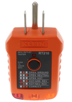

That is the clear advantage of using the test button on your standard GFCI circuit tester. Actually test that the load side receptacles are indeed protected.
