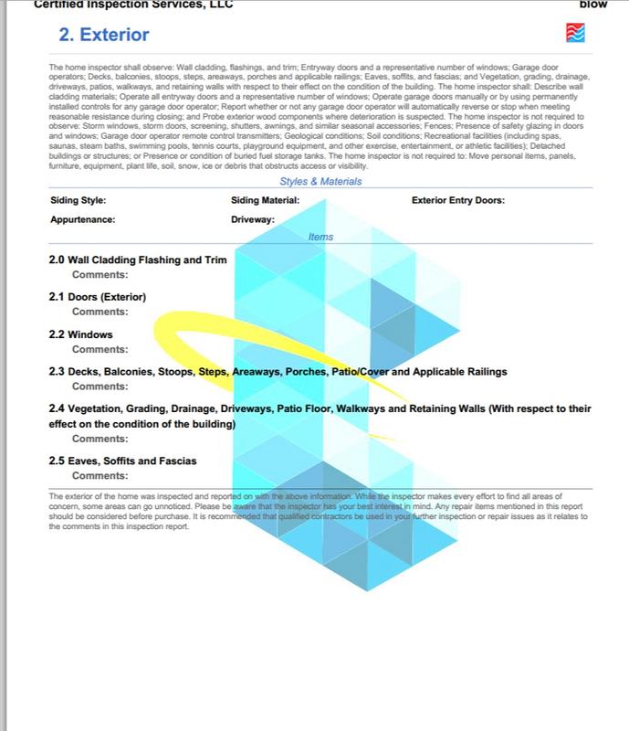

I modified the internachi template. Here’s a screenshot of my first attempt. I have since changes it.

This is the one I’ll be using. Faded version of my logo.

Looks good to me, better than my version in fact! Play with it some more, there are several freeware photo editing software programs out there to do it yourself.
