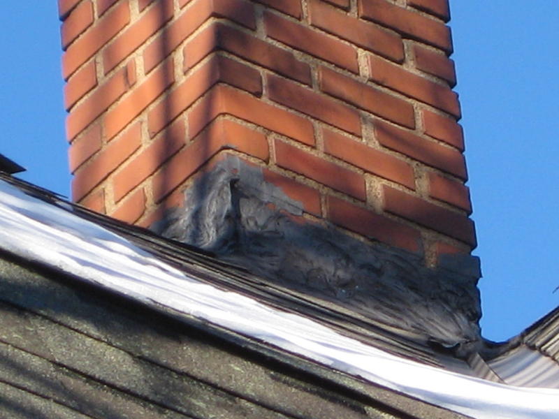

This was a steep roof covered in snow but the top portion of the roof was not covered and viewable with binoculars. Is that the adhesive strip showing from not enough overlap on the shingles or is it a decorative color to add texture to the roof?
Many thanks.
Michael
PS Yes I commented on the flashing, or lack there of, on the chimney :wink:
Could be a zink strip to stop moss from growing .
From that angle, it looks like a decorative shadow line made by alternating colors during shingle manufacturing.
Dom.
DO you have a link for shingles that are made in this fashion?
More info here Zinc Strips Prevent Moss Growth on Roofs
decorative color to add texture to the roof.
I agree with Dom and Dan.
Adhesive is not always continuous, but when it’s in sections, as far as I know there’s always a section terminating at each end. In the lower left you can see a joint where shingles in the same course butt, but the dark areas do not meet.
Thanks everyone for your thoughtful replies. That was my thought as well and I left it off of my report, but I couldn’t be sure because of the snow and ice on the lower parts of the roof.

What did you see in the attic?
I agree with Roy. Do not let the zink strip fool you.
Now that valley if professional installed. Go by what you see done right if you can not view the roof. The attic space will reveal what you need to know.
LIMITATION. I could not inspect the roof. I was dangerous to negotiate. Snow covered and x/12. We will come back in the spring and do an visual roof inspection free of charge.
