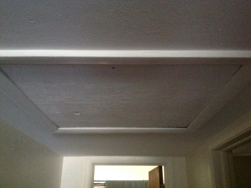

No crawl space here, thought I’d snap a photo of the attic access. Measures 30"x30", plenty big enough to be above the min.

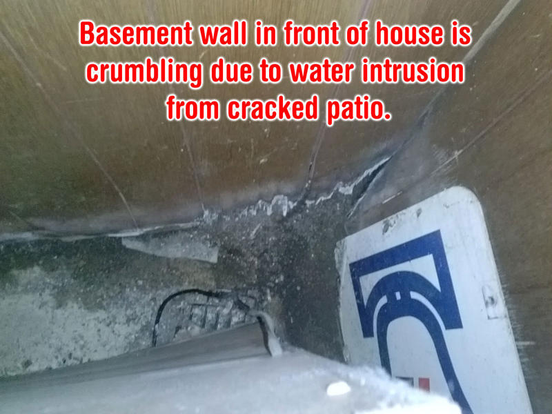

This is a view looking down behind a couch in the basement. The concrete patio on the other/outside of this wall sloped towards the property and was also separated from the structure leaving a gap for water intrusion. You can see that the wall is crumbling behind the paneling.
