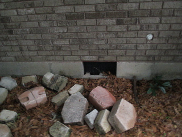

as you see on one picture the home elevation and the drainage. the road is about 5 foof above finish floor and water drains straight toward the vents for crawl space(see picture ). the concrete around the vents, which are about 1 foot below grade and water just pours in during a good rain. signs in crawl space.

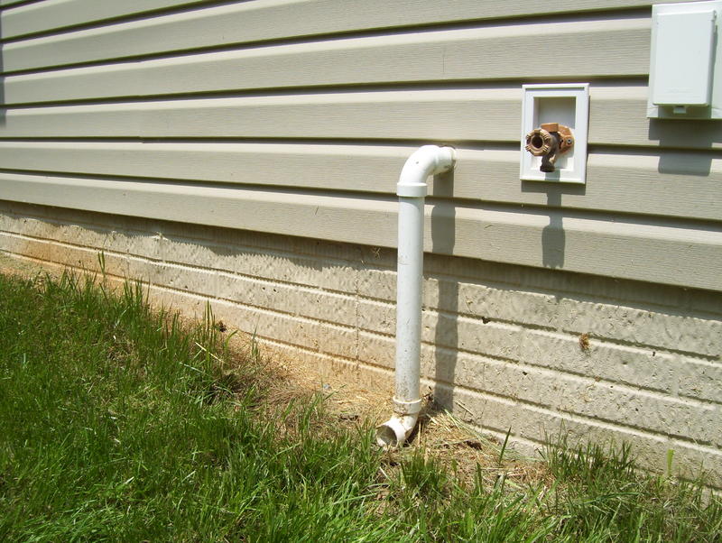

I took these two pictures of a sump pump exit pipe. It is 1.5" Schedule. 40 PVC pipe , glued and elbowed down to grade level. The owner has removed the extension which lead away from the foundation probably so they could cut the grass. The other 2 items in the pictures are the outside hose bib and the GFCI electrical receptacle in it’s weather resistant enclosure.

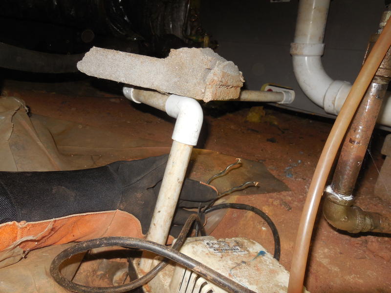

Improperly supported piping was observed in the crawl space. Plastic piping should be supported by rigid hangers, rather than metal strapping. Recommend proper pipe support be installed by a qualified contractor.

The float switch on the furnace condensation pump is not connected. This switch, when properly operating, will shut off the furnace if the condensation is not draining and water backs up into the line. Recommend properly connecting this float switch by qualified electrician.

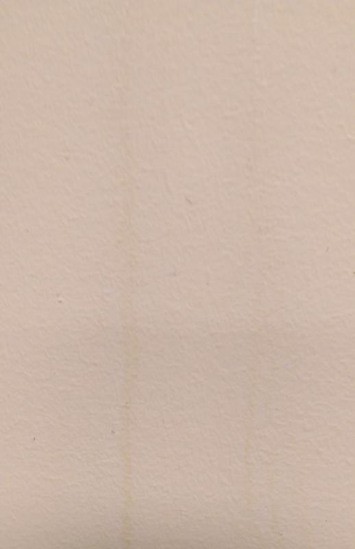

Per class requirement, attached is a photo of water stains on an interior wall. You cannot see from this picture alone, but the water stains were evident near the ceiling tiles and flowing down to the floor, showing evidence of a water intrusion event occurring in the past.
