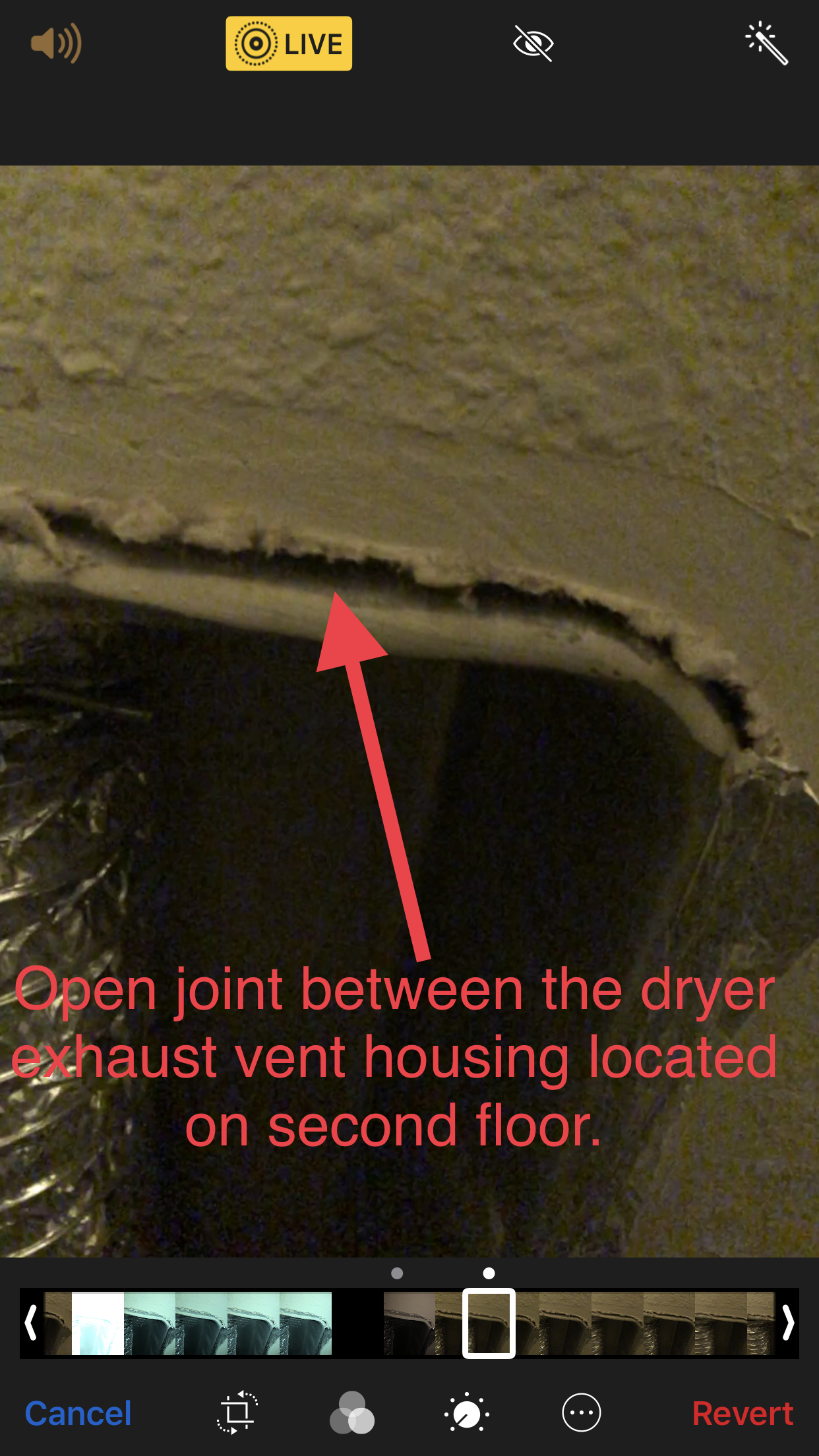

This image shows an opening between the drywall and the dryer exhaust hose housing. This particular housing is located directly behind the dryer on the second floor of a two story house built in 2013. As you can see the opening was not sealed or finished properly and is a point of air escape compounded by the stack-effect. This can contribute to loss in interior pressure thus causing a vacuum in the lower part of the house which could contribute to radon gas entering the house through the slab on grade. Although this house is relatively new and has polyethylene sheeting below the slab it most likely will not suffer any serious radon entering the house. If this were an older home with a crawlspace without any radon mitigation in place it could be seen as a radon concern.

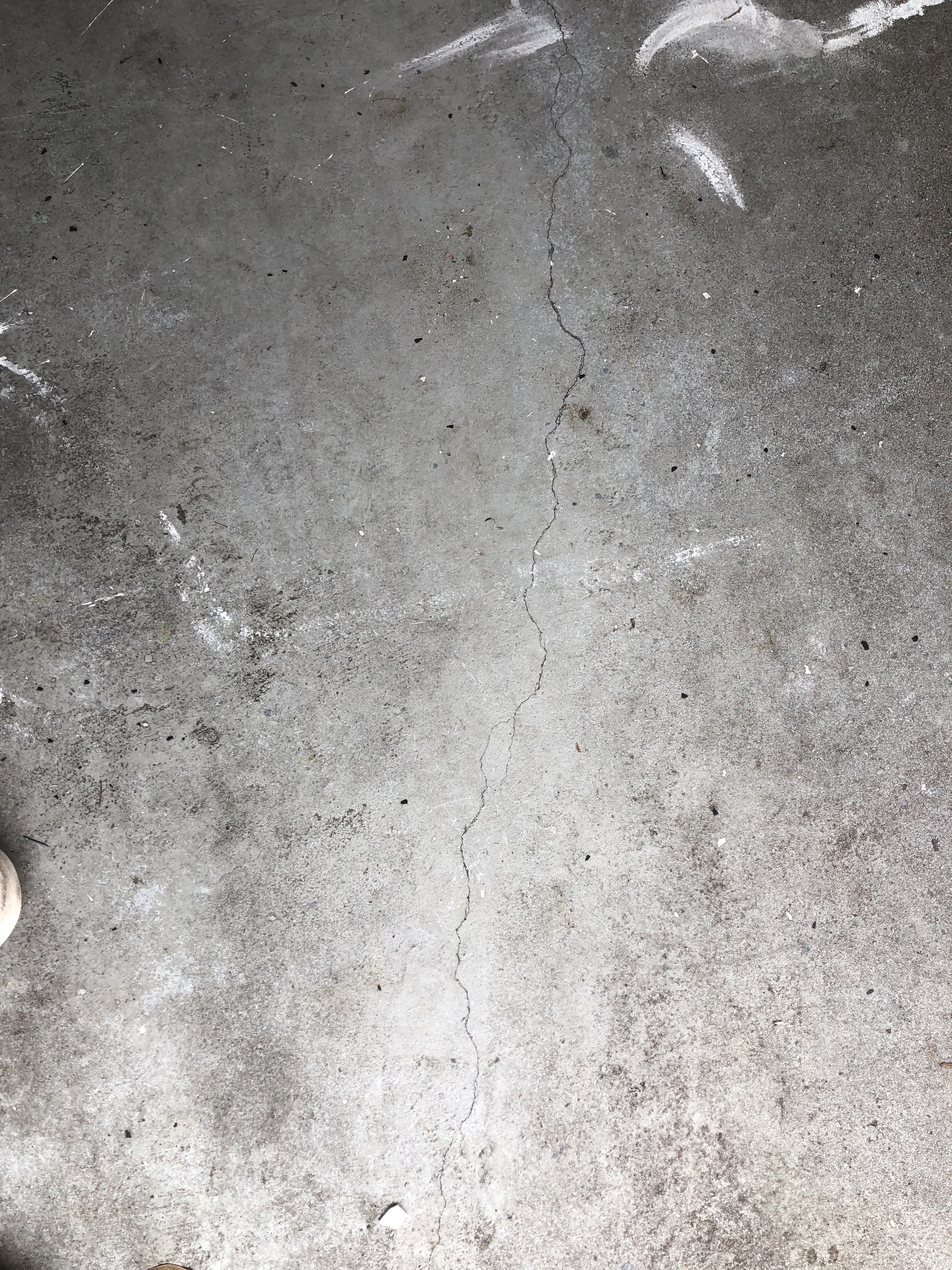

In the image that I’ve taken is of a garage floor with obviously visible crack in the concrete. In this case the crack are in a bare garage floor with no covering material, such as there would be in the interior of a dwelling such as, carpet, wood flooring, or linoleum, etc; However cracks similar to the one pictured can exist unnoticed inside the dwelling floor space, that are potencially increasing the amount of radon that can enter the interior envelope of the dwelling. The one surprising fact that I’ve learned from taking this course is how detrimental radon inhalation can be on one’s health, and that it is the second leading cause of lung cancer. Smoking tobacco products is the number one cause of lung cancer. So in practical terms you may never smoke a cigarette in your lifetime, but if you live in an environment that has high levels of radon, you could develop lung cancer!
