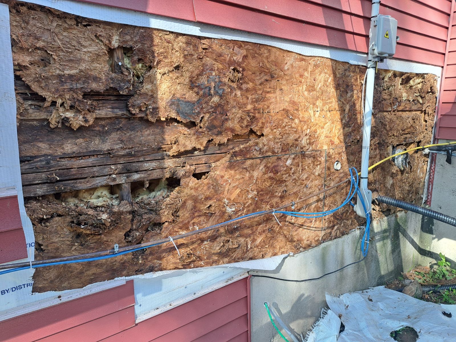

In October of 2022, an inspection was performed on home X, where kickout flashing had not been installed.
It was recommended due to staining down the vinyl siding (moss/ lichen, etc) as well as soil impact depressions, etc.
Today, nearly one year later I received this image from the client, saying that when the roofing company came to remove siding for the kickout flashing this was discovered and started at the lowest level.
The damage was behind tyvek, and behind vinyl siding.
And recommendations on how best to navigate this, client is not thrilled, but there was no interior indications of damages, staining, mildew, etc.
Any actual advice would be recommended as this is my “first issue” in the 4 years service.

“Kick out flashing is recommended to be installed on the rear portion of the garage, where the roofline meets the homes vinyl siding.
The kick out flashing as shown in the attached image, helps divert water shed away from the dwelling, reducing the possibility of water intrusion behind the siding.
The installation of a gutter and downspout to diver the water away from this area is also recommended due to the visible soil erosion, high moisture content as well as the location of vital components of the home. (Heat pump, electrical main service entrances, etc.)”

Looking at that photo, that is hard core damage assummed caused by the lack of a kickout diverter. That worst damage appears to be quite a distance from the corner. Do you have a picture from further back so we see the bigger picture?
I’m thinking something else contributed to the water intrusion behind this weather barrier at one point.

This looks like a pretty old problem. Question is, was the problem presenting itself at the interior at the time of the inspection? Looks like a basement home
I concur 100%.
Kick-out flashing??? Me thinks your barking up the wrong tree.
Bullseye!!! That is interior moisture migrating outwards.
Likely Bathroom & Laundry room. Look at the dryer vent material and missing vent.
