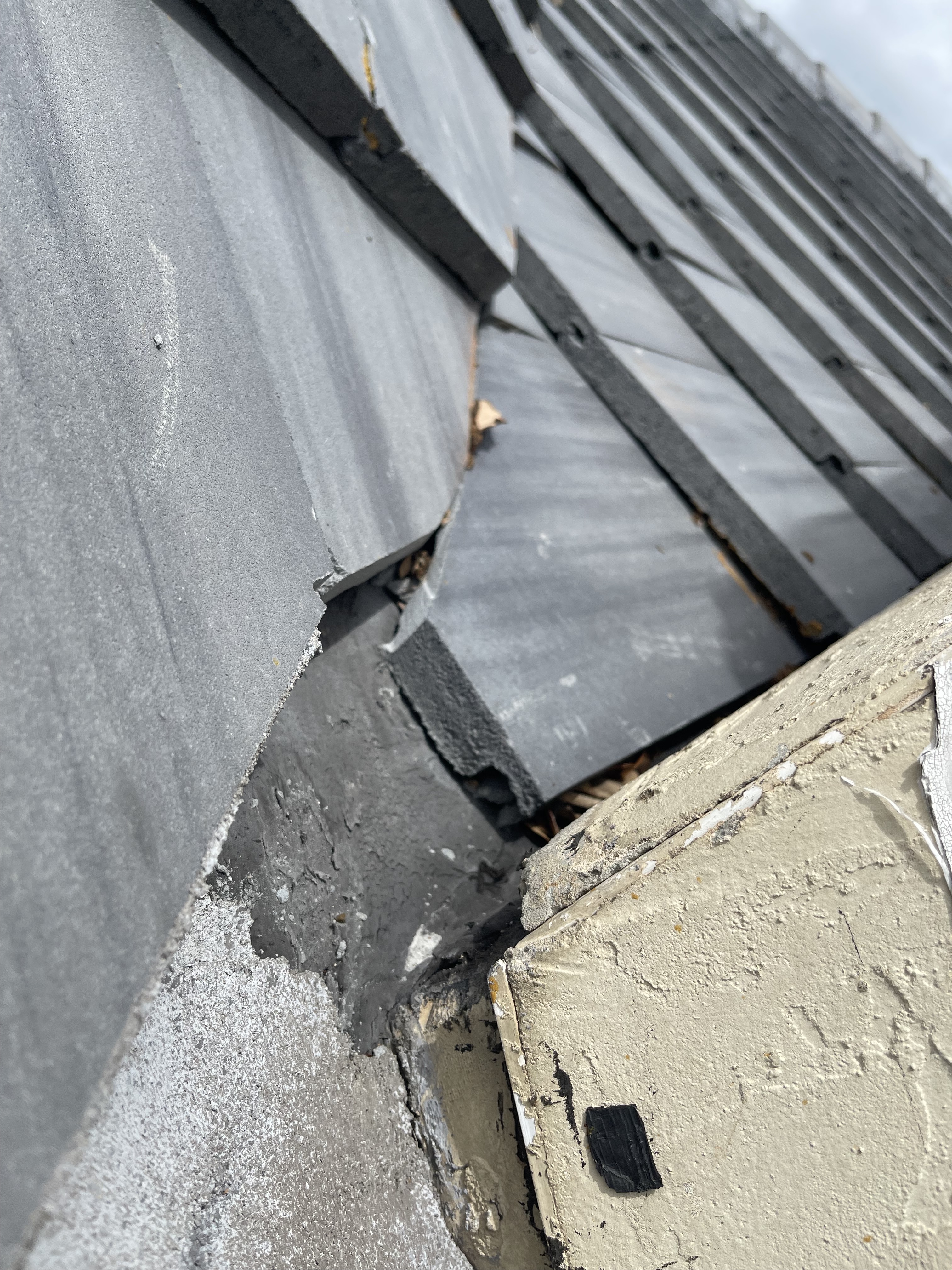

Is this picture normal for Florida roofing? It looks like there is no metal flashing, but it could be covered?
Yep, normal. Correct? NOPE. Refer to the FRSA-TRI Installation manual and FBC…
Larry, 7th edition went into effect this year. Heres the updated TRI-FRSA guide
