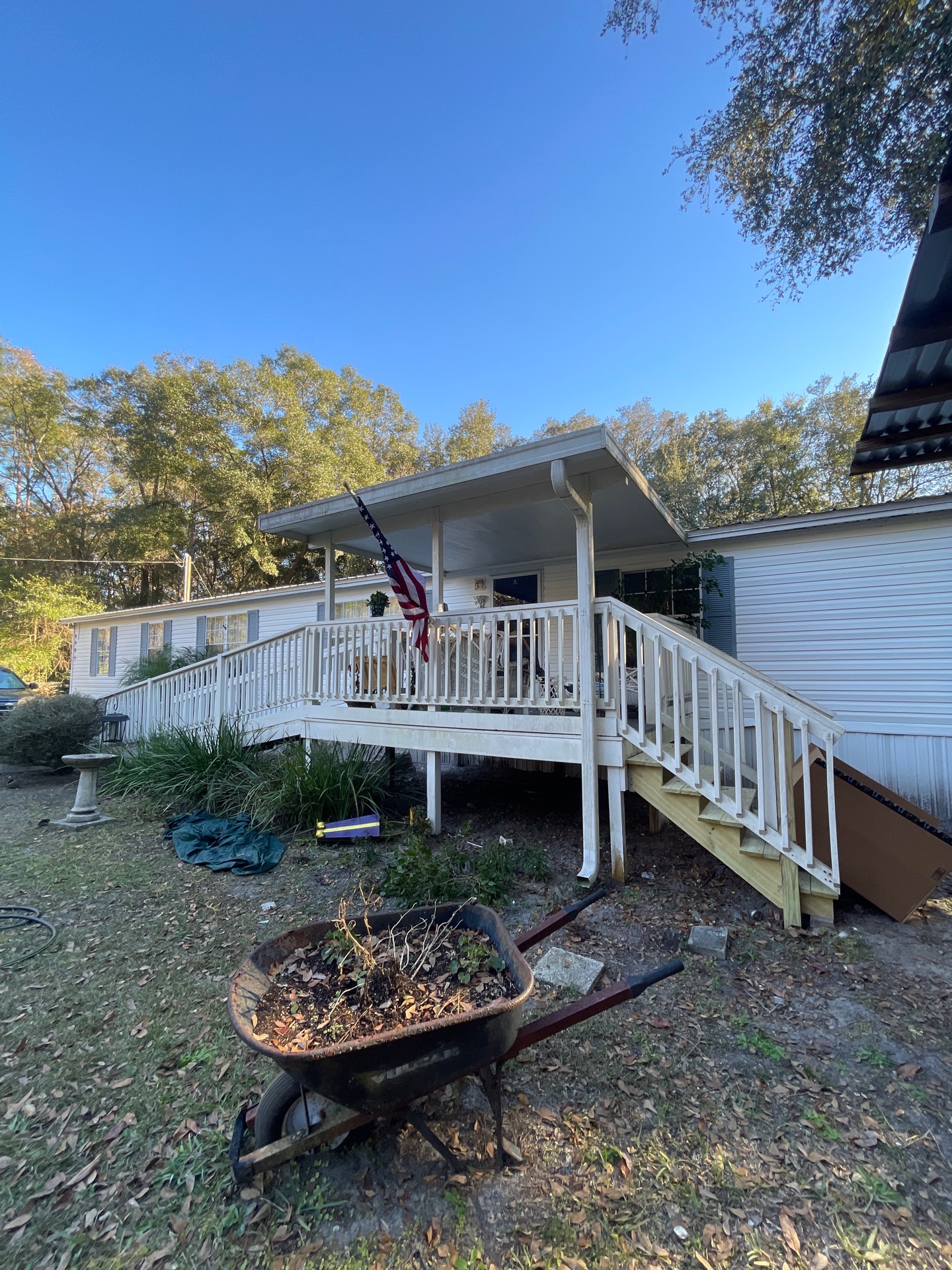

Attached is an image of an email I received from a client, I was looking for some advice on what I should respond with to her. Below is some back story and my thoughts.
She reached out for an inspection on her front porch and awning along with her back deck. I completed the inspection, sent her the report, and received this email. My thoughts are, I have an opinion on if the additions would affect the structure but I’m not an engineer, I didn’t run any calculations on the structure & home. I inspected the structures she requested per internachi standards and these standards are referenced in the contract she signed and agreed to before the inspection took place.
Am I wrong for not wanting to give my opinion on these additions affecting the structure? I don’t want to be held liable if something happens.
Along with this, the image is saying she needs to schedule a structural inspection of the home if she has not already. If she did request this, should I get clarification on what her mortgage company is asking for? An internachi standards inspection or a structural inspection from a structural engineer who will run calculations and such?

It’s only allowing me one picture per post so I will reply twice. Here is the front porch and awning, this structure wasn’t bad.

Based on the wording of the request, I wouldnt have a problem saying it didnt affect the load limit, because those are both free standing.
But that is up to you.

I agree with the necessity to be free-standing on a Manufactured/Mobile home,
BUT…
It is debatable if those are connected in any way to the structure.
If there is connect, they need to be certified by an Engineer to meet the terms of that letter.

She’ll need an engineer to supply a report confirming structural soundness or foundation condition.
The lender is requiring a manufactured home foundation/addition certification. Very common, and must be done by an engineer. Very often, home inspectors work with engineers to get these done. Inspectors typically do the field work and send the pics/info to the engineer, who then writes the certification report to be sent to the lender.
Rocket Mortgage is looking for a PE to say the deck at front and rear along the front awing roof does not impact the structure. Basically nothing can be attached to the mfg. home. The front porch roof can’t be attached and the decks must be freestanding with post at each corner and can’t depend on the walls of the mfg. for support.
Based on the pictures I would say this mfg. does not meet those requirements.
I agree. The additions would fail the certification. Loads are being transferred to and carried by the mfg home.
How is the front porch roof free-standing? If you took away the manufactured home, what would support that end of the roof structure? Also, how can you tell for sure how the front porch/deck is free-standing and not utilizing the manufactured home as support?
I agree. Should I ask her to get clarification on these items? Not sure who exactly is asking, all she said was rocket mortgage.
The roof over the front deck is supported by the manufactured home next to the house. That alone will require an engineering report. I include a beam and column design to support the roof or deck when I do this type of inspection for mortgage companies.
