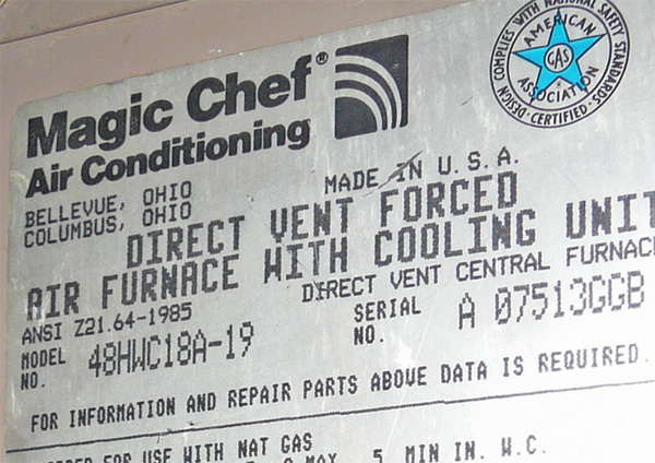

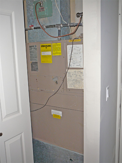

Hit a dead end on this one, anyone wearing their secKrit deCoder Ring this afternoon?
Hey, Michael.
On the Magic Chef, use the last three letters, GGB. The first letter is the month, the second letter is the year, and the last letter is the manufacturing plant.
G month = July
G year = 1986 (which fits nicely with the ANSI date of 1985 there)
Thanks!
