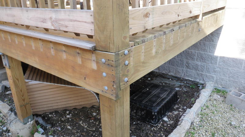

Did a water intrusion inspection on a 3 x 3 split faced block condo building. Typical problems. But get a load of the issues on the back porch! I could not even believe this.
  1. Corner posts overly notched. May be just a Chicago thing, but they want no notches, through bolting with, at least, 5/8" bolts and brackets under the beams.

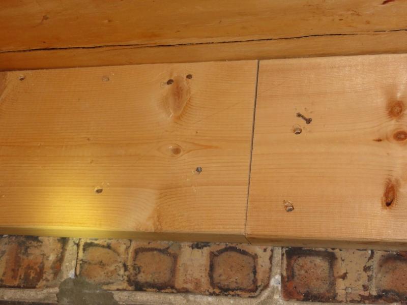

  2. See this? It was under a landing on the porch.

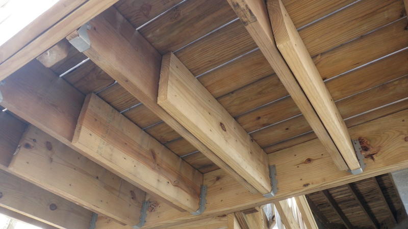

  3. They didn’t have long enough joists, so they distered the joists and connected them with screws!

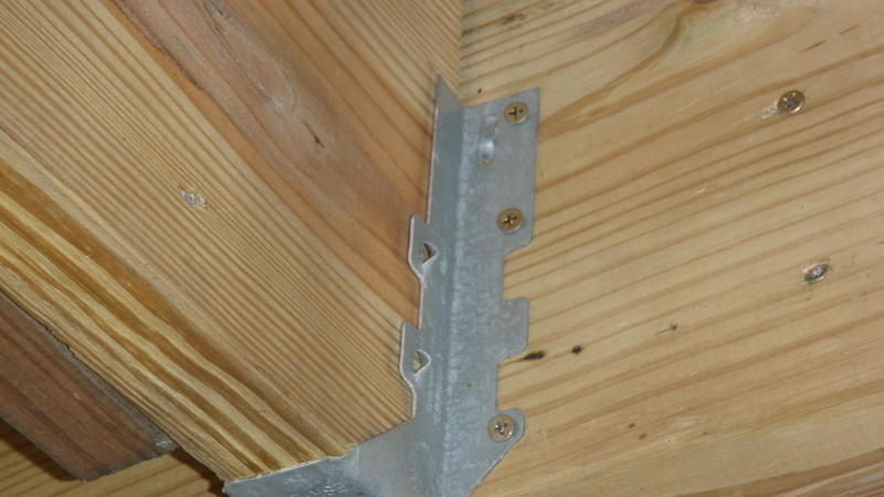

  4. The metal hangers were a) undersized, b) secured (when they were secured) with screws and c) no screws in the actual joists.

Not bad actually since at least they left some of the wood on your splice.
Not sure if the no shear strength screw or the no grip nail is worse however.

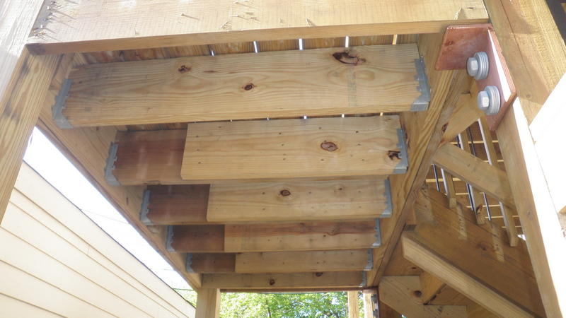

I make it a point to check porches at every property I visit and in this case the guy built it himself.Can you tell?:slight_smile:

Bob, that stairway is a catastrophe waiting to happen. Nailed ledger board?
I don’t blame the code inspectors, so much, as I blame the idiot who built it. The law looks at it like that as well.
