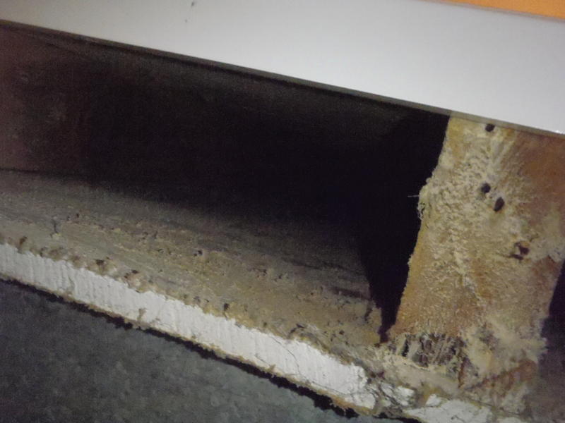

What I noticed was a very poor architect.

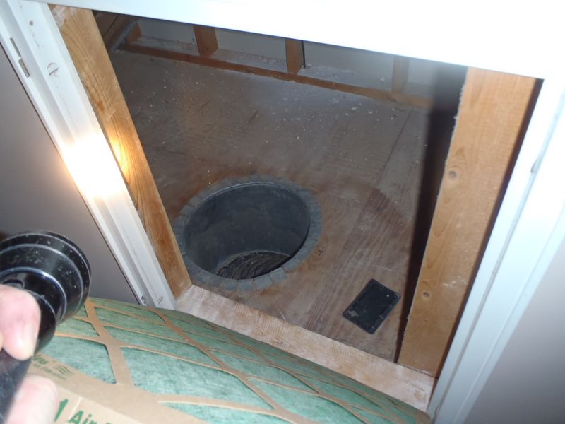

To get back to the question;
Return air; stud partitions ok if limited to one floor, and isolated with tight fitting metal or 2" wood. IRC 1601.1.1 UMC 602.1
Supply air; stud partition NOT ok for supply air. IRC 1601.1.1 UMC 602.1
If it is new construction (not a 100 yr old house) there is Nothing Right about it (in my book). There are so many things wrong with it, I don’t have the time to list them all.

2009 International Energy Conservation Code
403.2.3 Building cavities (Mandatory). Building framing
cavities shall not be used as supply ducts.
Do you consider a return air a “supply” ?

I did scratch my head but followed the path or flow into the furnace. No issues. metal over joists.
