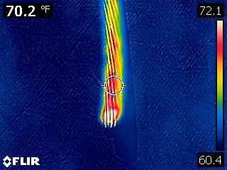

I was reading this thread, and it really sparked my interest. The good thing is I happen to have spare parts lying around to do some testing. I do realize the OP was taken right on top of the lug, so it is most likely reflected IR. I wanted to see what would happen if I raised the temperature manually. Please be aware I am still learning how to use the camera, so keep the criticism constructive, and I am open to suggestions. Here are my results.
FLIR0041
This is one end of a neutral wire after sitting in front of a space heater for 3 minutes.
FLIR0042
This is the other end that was not heated.
FLIR0056
Here is the neutral wire in my box.
FLIR0057
Same neutral wire after being heated by a hot air gun. I don’t think it’s the wire showing heat, but the air surrounding it causing it to glow. And yes, the whole area was affected, but as in the pictures above, it does seem to glow when warmer than it’s surroundings.
This is the best my C2 camera will take. I cannot figure out how to save and copy the non-ir photos using FLIR tools. If anyone has suggestions let me know. I can always add them to the post later.
