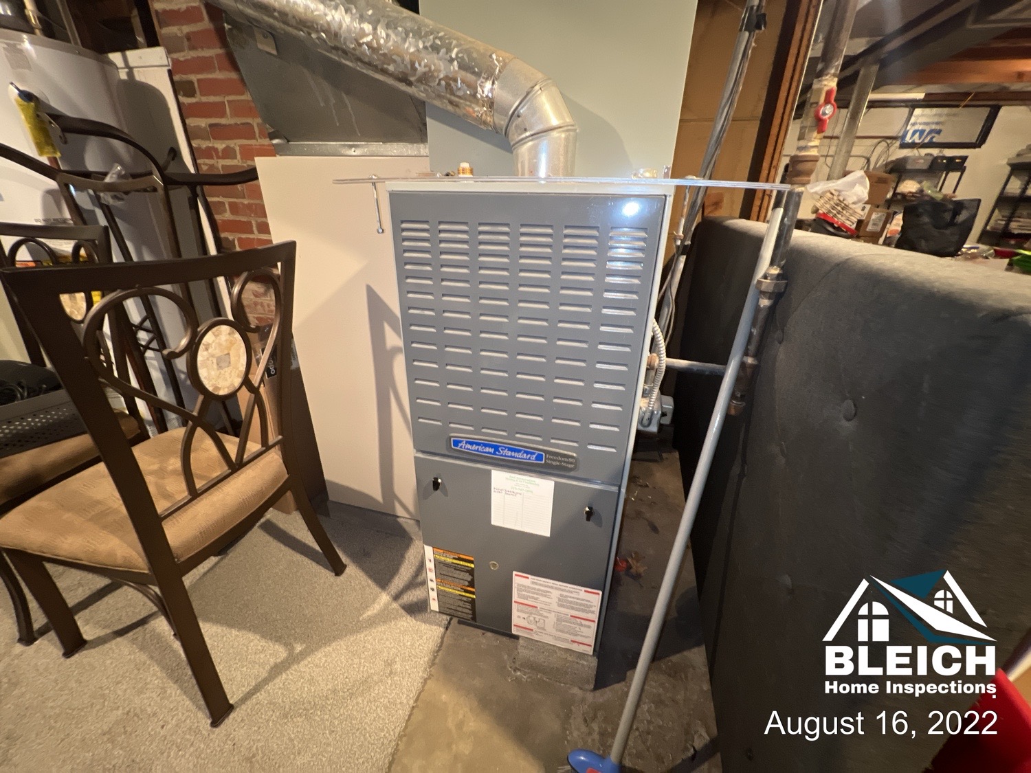

I’m having a hell of a time determining the manufacture date of this American Standard furnace. I cannot find this nomenclature on building-center.org. Can someone help me out?
2001
Thanks Brian. You’re a gentleman and a scholar.
No problem, I learned warranty look-up from @jfudge Just passing it along.
The first letter of the serial number (Z) indicates 2001 manufacture. See How can I tell the age of a Trane furnace from the serial number?
Interesting I have used building intelligence center most of my career and am now a little concerned since on their site the code value falls under a code 5 and the Z is a 1986 and S is a 2001
Is there a specific way to look up warranty info, not sure I can trust Building Intelligence Center anymore.
Well, I just google “American Standard Warranty Look-up” and click my way around.
