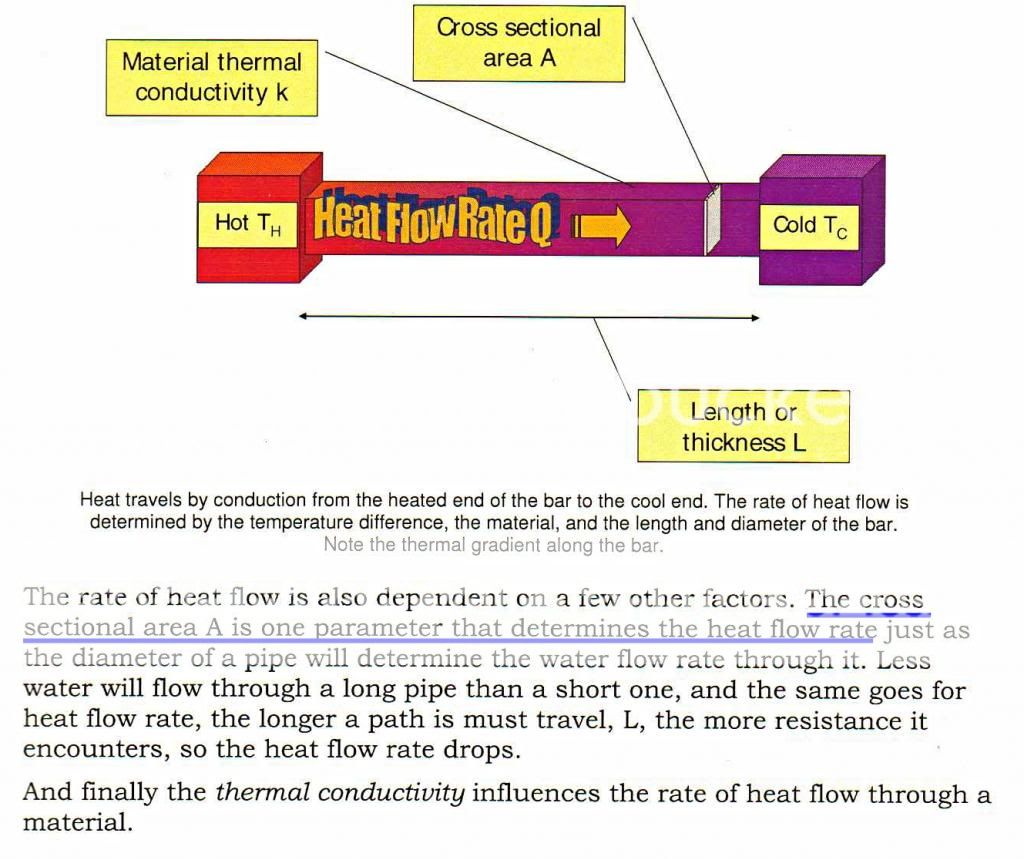

Please prove it (without the internet hype).
I don’t care what others “think”. I did not believe this either.
Again: This is** not **about the “Rate” of transfer, it is about the “Quantity” of energy involved.
For Plumbers: If you have 1 psi on a water line, one is 1.5" and one is 1/4", which one will have the most volume discharge in 1 hr.?
For Electricians: If you apply 120VAC to a conductor, one is 10ga and one is 28ga , which one will deliver the most wattage in 1 hr.?
Then if you add length to the wire or pipe, what happens to the flow?
Didn’t John McKenna go through all this in IR Certification?
This is just Level I stuff straight from the ITC Level I training manual.

I didn’t say anything about the course for you to be scolding me on. I simply asked if that was not covered. My posted example came from the same book John was trained from…
Thus you should have been, also.
So in theory, the length of time at a certain deltaT could result in a completely different IR image as heat transfer occurs through the metal stud? What I mean is there may have been a point much further into Charlie’s test where the loss of heat from the drywall and plywood was greater between studs than at the studs and they would have begun to appear?
This would occur because heat was continuously transferring through the studs from the outside at a relatively steady rate and quantity, assuming consistent outside conditions, but the absorption rate at the interior wall would overtake the rate of heat transfer through the studs if enough cool air was being pumped into the room by the AC unit.
And if the wall was wood framed, even though wood doesn’t conduct heat as rapidly as metal the cross-sectional area of the wood stud is so much greater that the quantity of heat transfer would occur faster?
