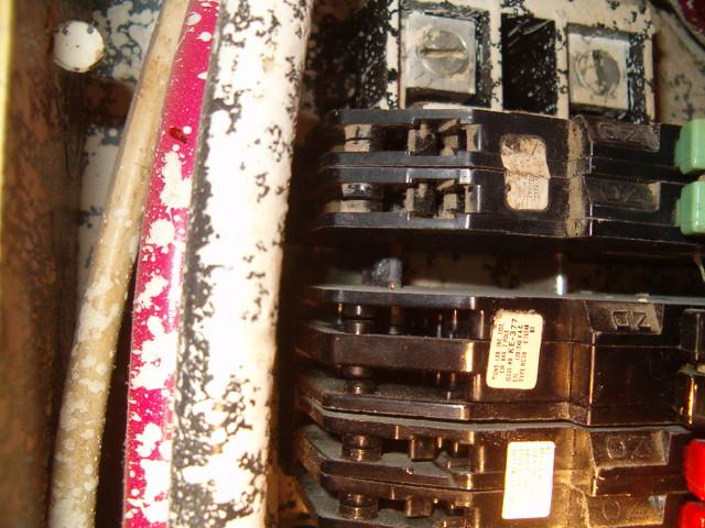

Another day of Zinsco
This panel had several problems (starting with its brand name).
You could hear the sound of frying bacon :smiley: as this 30 amp, 240V breaker was “welding” itself to the bus bar.
Also pictured is a fine example of how not to avoid double tapping a breaker when you need to add a circuit (all wire sizes are still required to meet the breaker rating).
Great example of using the Thermal…I preach it until I am BLUE in the face and you would be amazed how many HI’s dont have a thermal…Man you are the ZINSCO KING…:slight_smile:
Looks like a nice spray paint job too Jeff…:wink:
Jeff “Zinsco” Pope :mrgreen:
Speaking of thermal. I used my thermal cam, just on a whim, to check out a panel in a conco before I removed the dead front.
Noted one GFCI breaker (whirlpool) was hot (about 100 degrees) and one 1 amp breaker was also warm.
Took of the dead front and the GFCI breaker just flew out. It was arcing.
The 15 amp breaker’s wire was also warm. it fed the furnace blower and it seems that the furnace was recently changed out and the new blower motor was rated for 20 amps.
Scary.

I went on an electrical service call yesterday and went to look at this panel and again I was not playing HI on this situation…BUT I went to the panel and it has (5) double taps and just was a MESS…Incorrect bonding jumpers and different sized breakers for…well…just a mess…
I was their looking at something totally different but had to go into the panel…well I asked her…Madam, are you the original owner of the house…
She replied yes, I said…has any wiring ( toungue in cheek ) been added to this panel since then…she looked at me and said…NO…this is how it was when it was first built…I smiled…what else could I do…I looked at the panel cover and saw it was inspected back in 1990…
I said Madam…are you SURE no one has added anything to this panel and explained all the issues…she got MAD and said to me…That is how it was done when it was built…nothing has been added…
Well…I know better…I know the inspectors at that time and NO WAY…so when I offered a suggestion to how to correct it she said…it was fine in 1990 and it is fine now…it was a MESS…she then presisted to tell me how good the electrician was that wired it and he did it that way and he was the best and…blah…blah…blah…blah…I smiled and said…ok madam…have a nice day…
BTW- I provided her a LIST of what was wrong in the panel and that it should be corrected and my FEE for doing it…she said that is not what I called you out here for…so I dont care about the panel…NOW…if someone says I should have fixed it or turned it in…get a grip…this lady simply did not care…
