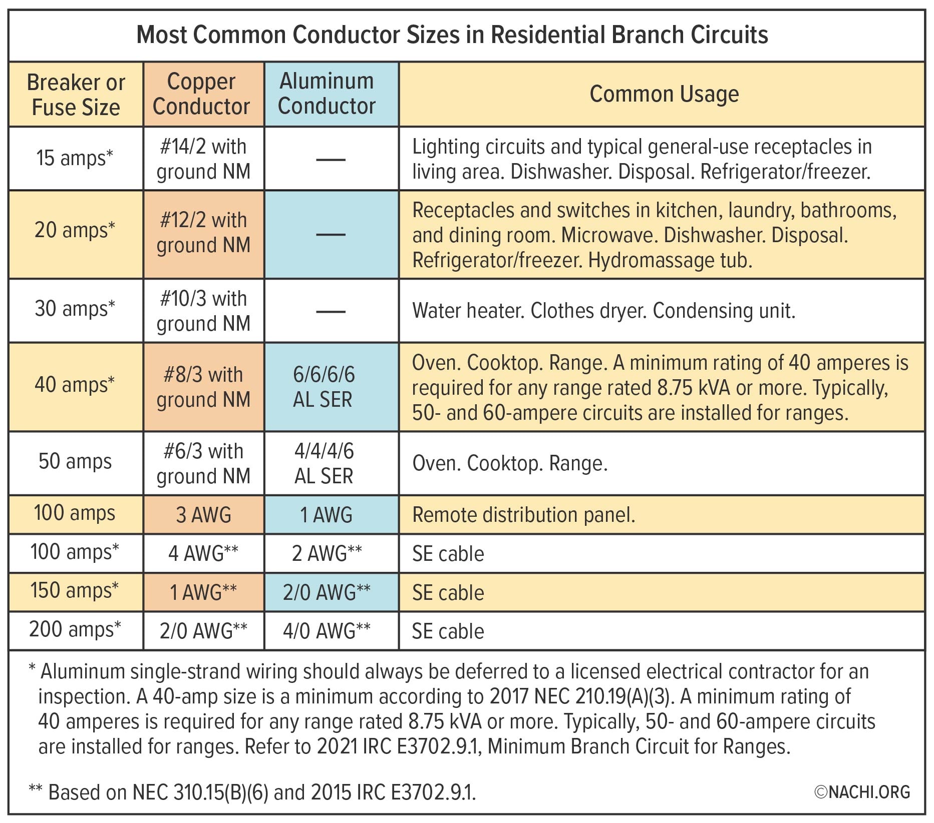

Another image added to the free Gallery: Most Common Conductor Sizes in Residential Branch Circuits
Interesting that you ignore one of the most often incorrect systems located in homes, especially older homes… Window and Through-wall Air Conditioners!!
What Is The Amperage Of A Window Ac?.
JJ, what’s your take on how these AC are incorrect?
Most commonly, incorrect duplex receptacles (not dedicated, such as with Microwaves, EV Chargers, etc.), with assumed undersized conductors, as observed by scorched outlets/cover plates/plugs.
Only so many can be attributed to old, out-dated units.
Note: I rarely see this issue in Commercial properties with PTAC units. When I do, it’s usually in 50’s-60’s era structures.
Why were aluminum conductor sizes left off for 15 and 20 amp circuits?
Lighting circuits typically would not be on 20 amp circuits.
Water heaters do not need 10-3.
