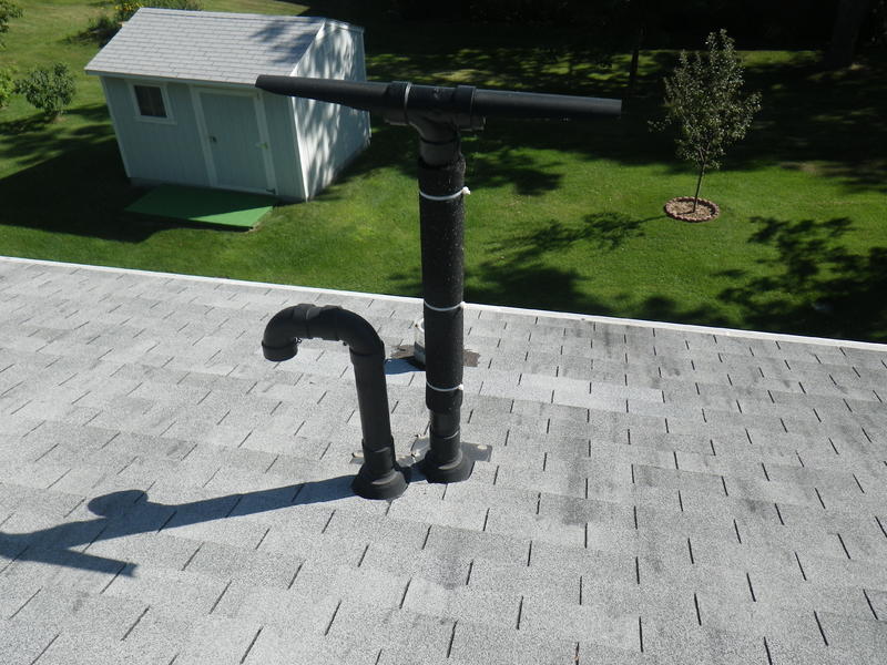

charlie…comb air from outside (see photo of funky vent and air setup) bob…no return as in no ducts for such. sucked all air through the furnace cover (complete with filter) and louvered bifold…and the added in vent in the main door. i said at least they tried to accomodate the air need but the fact remained that i could feel heat coming back (not when the furnace was not running) and fogged the mirror. i suggested there may be a need to add some fresh air supply but i hate to suggest fixes, also am reluctant to advise visits from high priced advisory personal…but im also adverse to the idea of being accused of not noticing a spillage potential (especially if it kills somebody) no pics…the situation was actually so compressed that a honestly representative photo was not possible. all input appreciated …you guys rock!!

Ok I think I understand what you have correct me if I am wrong I am just thinking out loud. A gas fired 90% furnace with exterior C air with the return thru the door of the furnace by way of the luvered door. Big problem gas fired WH in the same closet violates the 10 FT requirement. The return on the furnace will draw CO from the flue of the Water heater when ever both are operating at the same time
