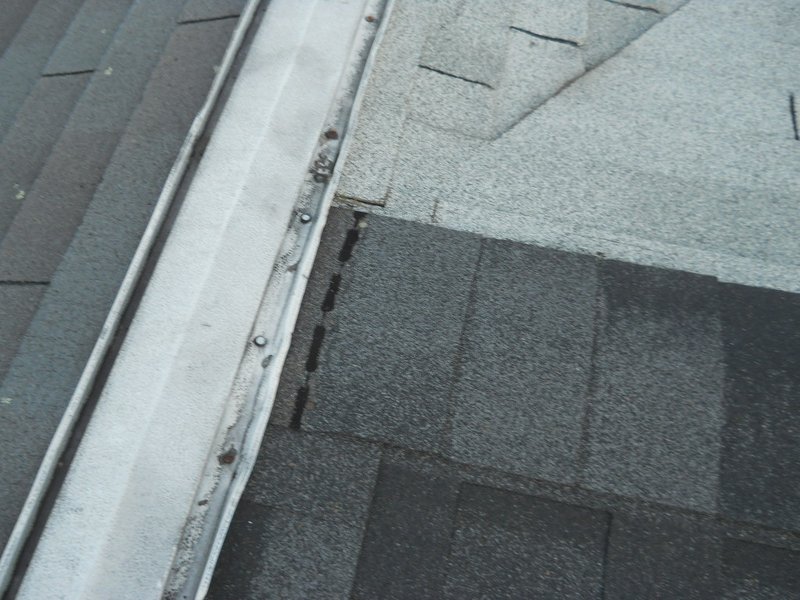

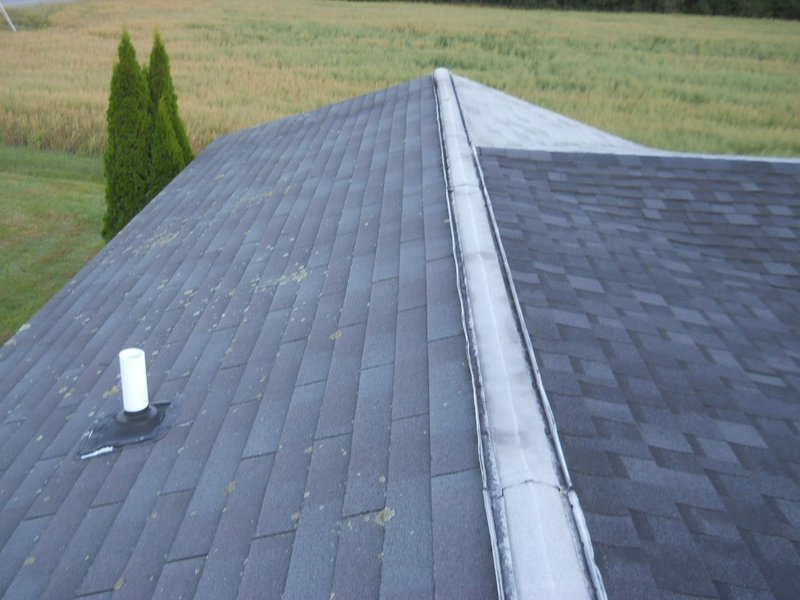

And so was this one.

WTF is that marcel? It looks like a zipper! no 4 inch seperation there
What kind of shingles are in pic 1 on the left? are those called 1 tab shingles?

Yup, regular IKO single tab, and 3 different types on the roof.
The 2" 3 tab offset was a new one for me.
The owner said, I can’t believe it is not installed per Manufactures Instructions, my Brother in Law did it. LOL.
Did this one this Fall.

That’s a classic case of stupid. 🙂
I had one in early 2013 where they provided the proper offset but instead of stair stepping the shingles they alternated them similar to what Marcel showed. Every 3 feet across the roof there was a crack through the shingles running from the top of the roof down to the bottom. :shock:
