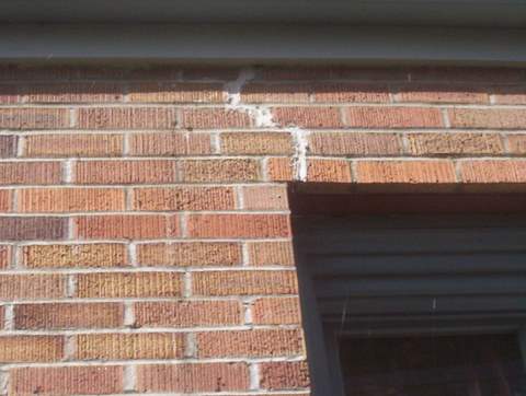

The structural issues, or some of them. These are all inside and outside of same outer wall.

# 3 is an issue the rest seem like normal settlement to me.
