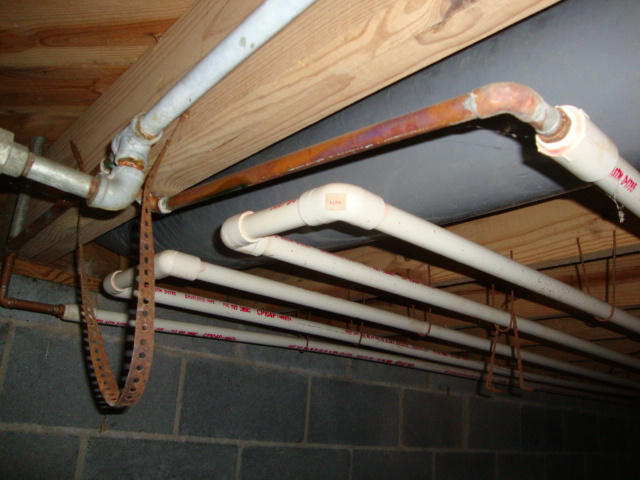

I discovered this today on a inspection. The home was built in 1964, with galvanize plumbing.
These plumbing pipes (pvc) went 20feet and there were 6 rows (120 feet) and returned back in to the main plumbing. It formed like a grill. I thought they may be used to compensate for possible restriction in the main in service galvanize piping. Any thoughts?? Note: water pressure was ok.
Let me guess… supplied with hot water, and the area above was susceptible to cold floors?
Red neck floor heat.
Exactly my thought. :wink:
