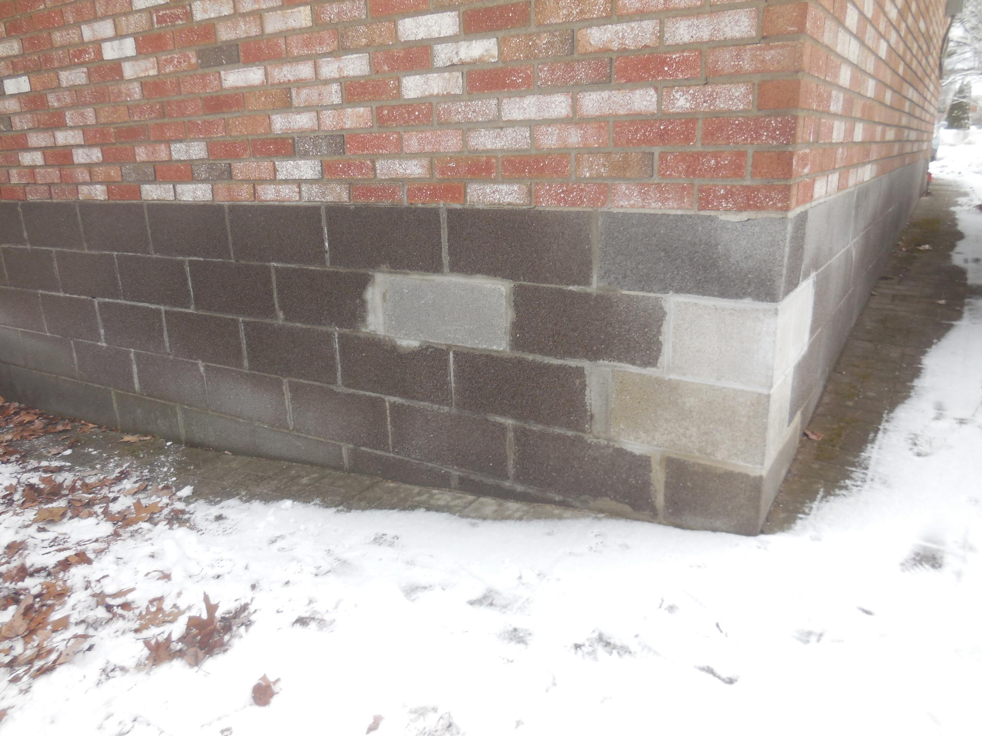

Block foundation walls were discolored. At first I thought they were wet but not so. It almost looks like someone added granules to the blocks like a parge coat. Some blocks look replaced. No basement on the other side of the blocks in this section, garage side of the home. Any ideas? Home was built in the 60s.
I see new CMU’s and new mortar.
Looks like a repair.

Perhaps (colored) “Cinder” blocks" with Cement block repairs… http://civilengineersforum.com/cinder-block-vs-concrete-block/

Thanks for your assistance guys.
