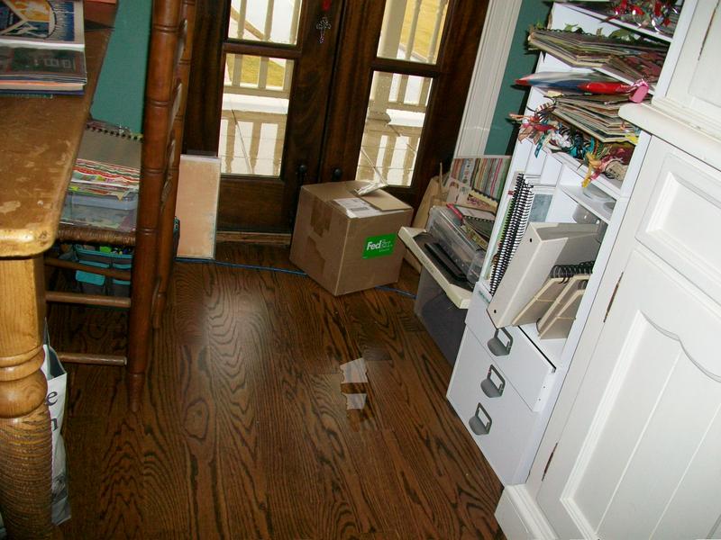

I had warranty inspection today and all the doors are leaking air and water. Owner asked what she could do
It has a large over hang but wind was driving the water into the doors there is about 11 double doors on this home.
Builder may not be much help on this one he file bankruptcy
Was the water leaking under the doors or the sill plate?
Under the door around the side and the top

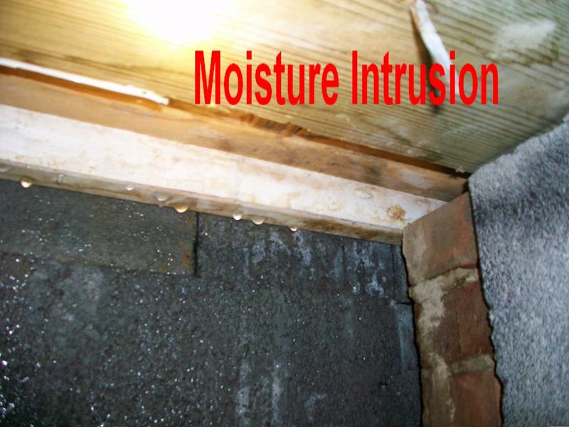

I did the Home inspection a year ago and warned about this they adjusted the doors and by eye looked sealed but water still coming in. 800.000 home
Plus water is going down onto the sill Plate in another part from the porch it is not going to good for sure

over hang on the front was 8 foot porch There water was running in when i was there
When i was there first it was back in FEB during a ice storm with winds it sounded like a wind tunnel

Sweeps are on, Most of the water is coming down the sides at entering at the corners
They have adjusted them several times only opening another gap somewhere else . I suggested removing some of the doors and replacing with windows. (Not a option) The doors are never used. I also said to seal all around the door using a high quality weather seal . They just need to stop the water coming in or i fear more serious issues are coming.
