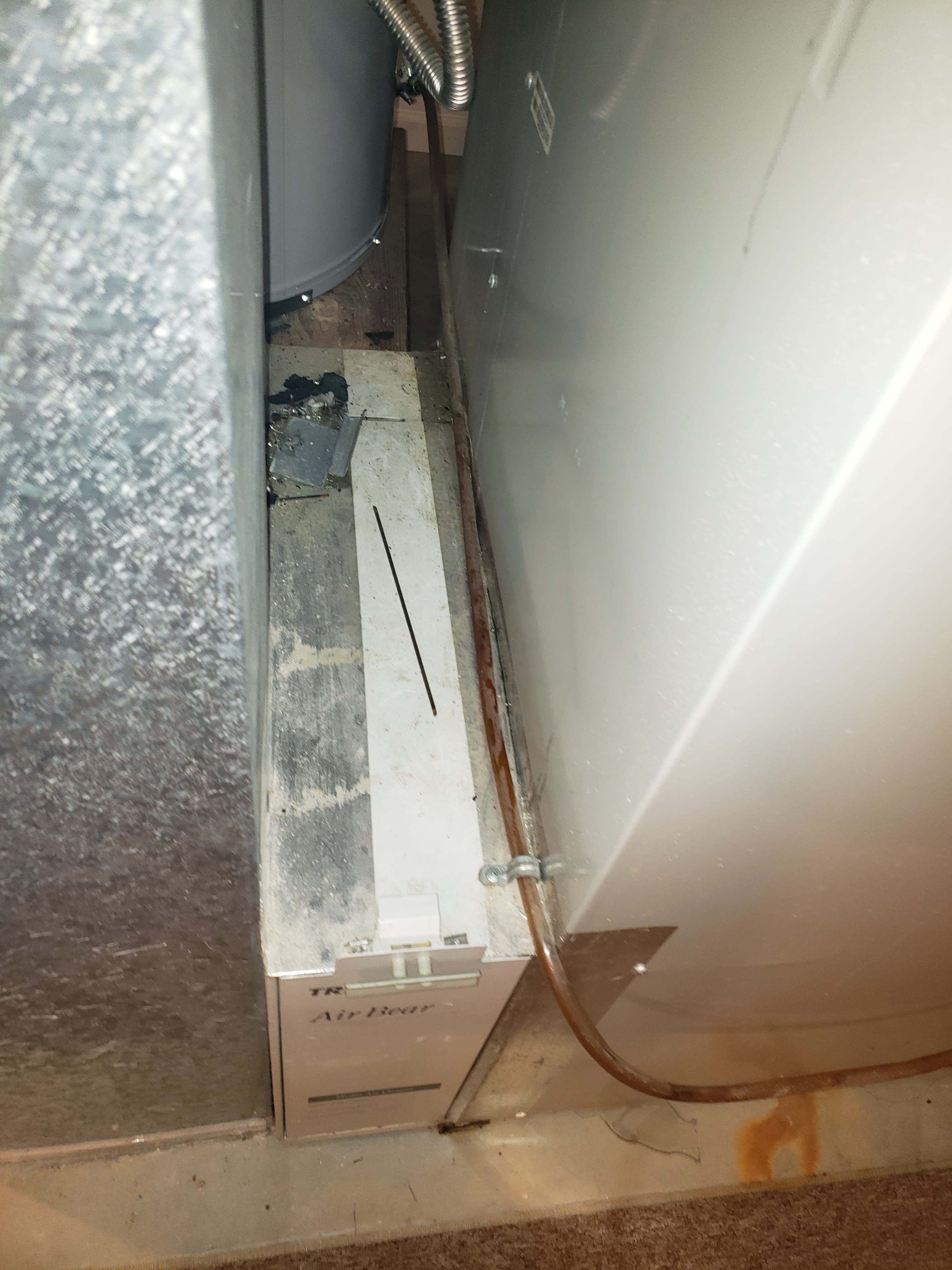

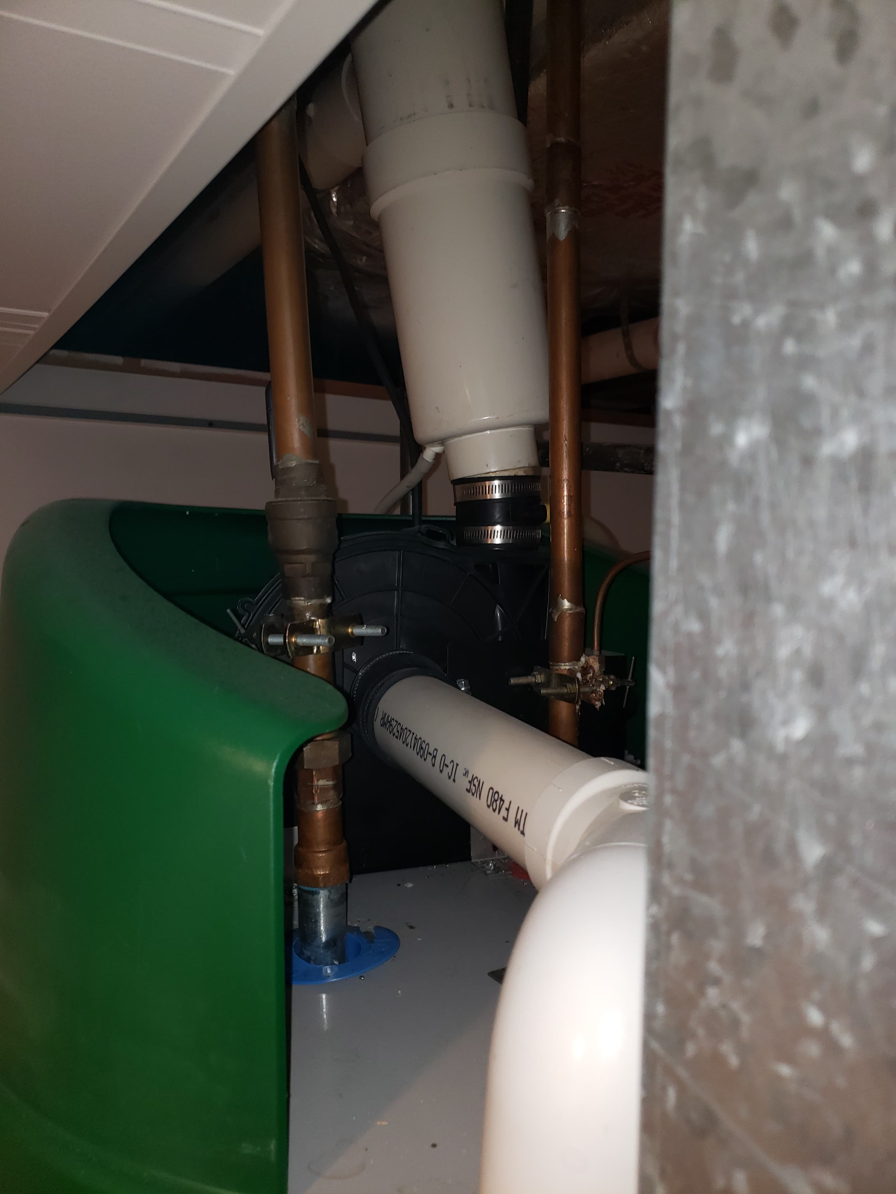

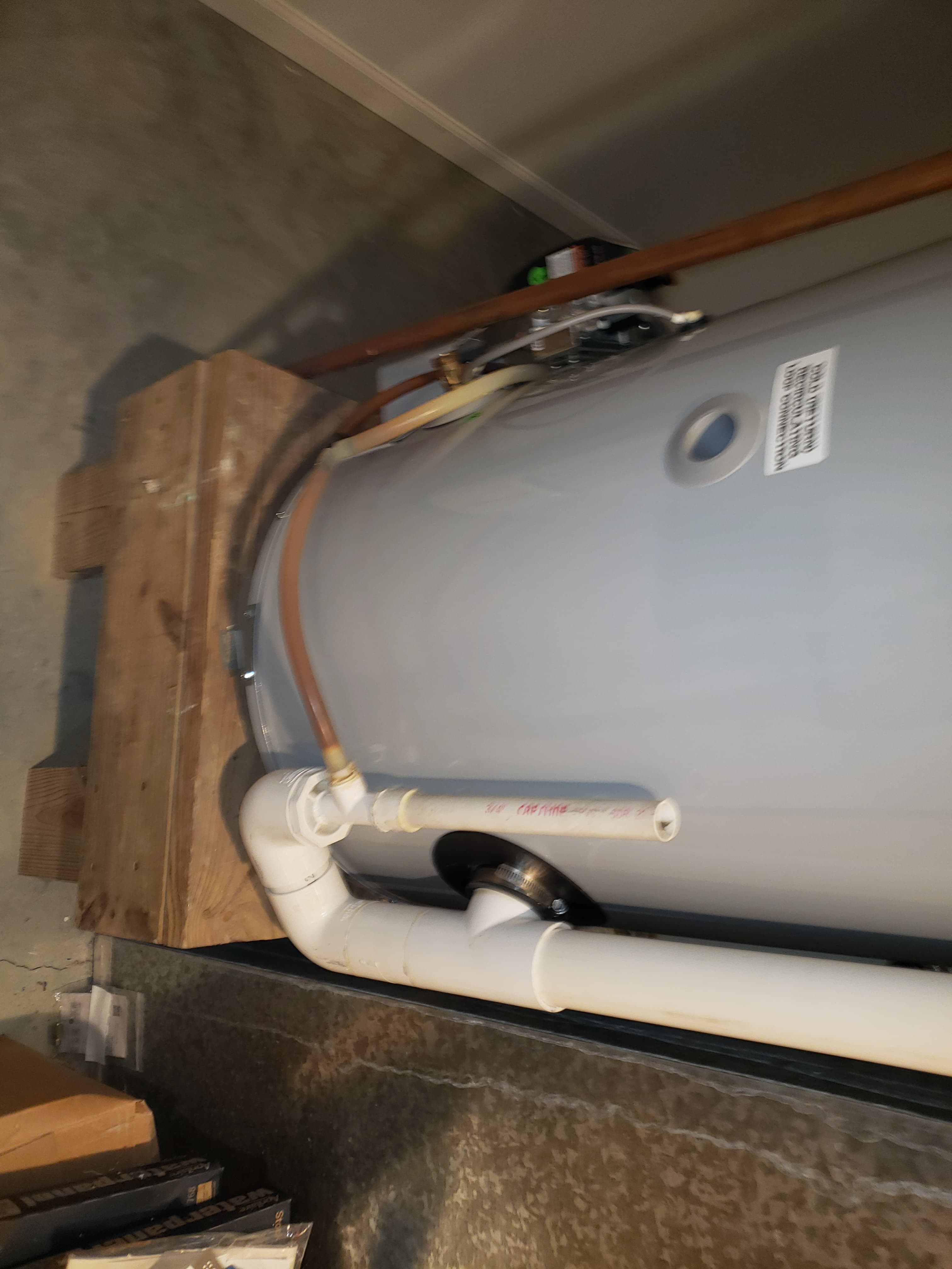

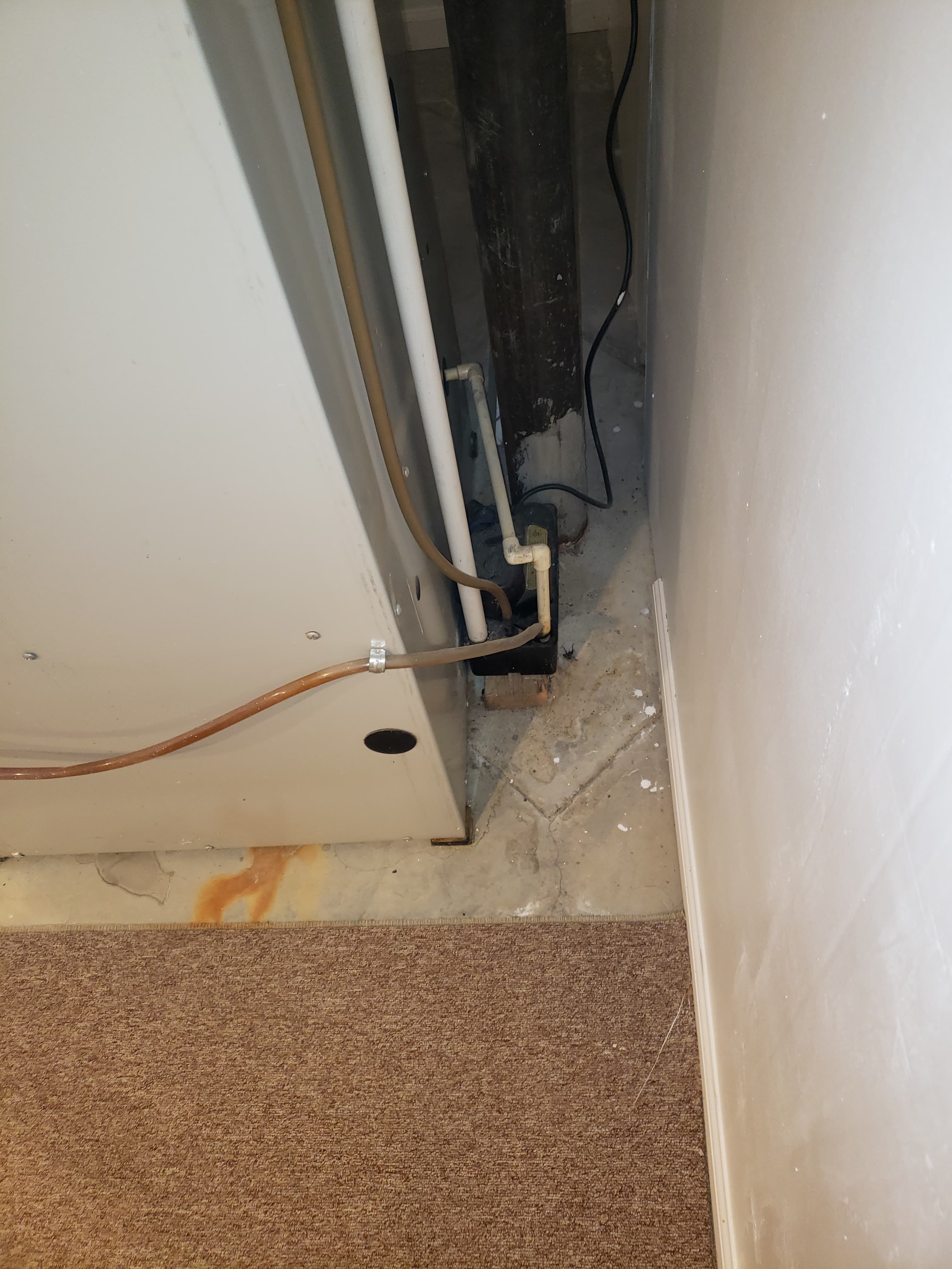

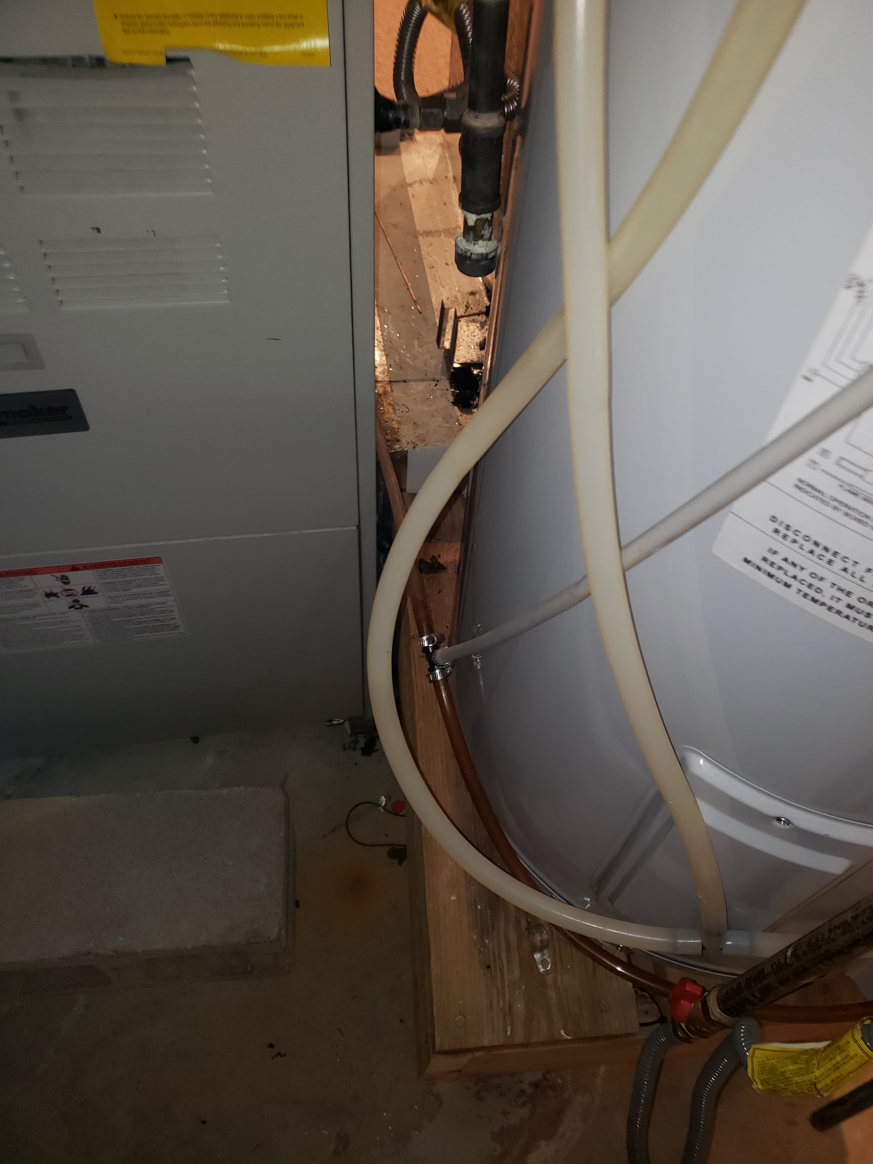

First time seeing one of these. I have been researching them. Just wondering if anything in particular to look for. I am going to try and find an installation manual for it online.
Essentially has condensate drainage that is connected to the furnace’s pump. There is a line that goes up and away for drainage but is inaccessible after the ceiling.
 ![20220921_103845](https://global.discourse-cdn.com/internachi/original/4X/e/0/0/e007a1b1eee91c3be8c9efaca56663296fcc69a4.jpeg)
 ![20220921_103759](https://global.discourse-cdn.com/internachi/original/4X/d/6/0/d6050466a8c6d345d6f4e72d0f75df97cf30512a.jpeg)
 ![20220921_103756](https://global.discourse-cdn.com/internachi/original/4X/4/c/4/4c4a6189c6398d94cd1dddc00614dd3f2245f262.jpeg)
 ![20220921_103750](https://global.discourse-cdn.com/internachi/original/4X/6/a/c/6ac957ddb7aafec20c04d895b80f811060f271b6.jpeg)
 ![20220921_103742](https://global.discourse-cdn.com/internachi/original/4X/0/5/4/0547f22e43b557b57efc67c190cef59af93c9c90.jpeg)
 ![20220921_103738](https://global.discourse-cdn.com/internachi/original/4X/b/2/8/b2841955a792fce8e48cb1aa29434d7afa79891b.jpeg)
 ![20220921_103733](https://global.discourse-cdn.com/internachi/original/4X/c/4/6/c46aeb081955d63ace6a6728beaaac1600272aa9.jpeg)
 ![20220921_103736](https://global.discourse-cdn.com/internachi/original/4X/d/c/9/dc90c2055a6c17f4800caa65a78b2250d165c32e.jpeg)
 ![20220921_103722](https://global.discourse-cdn.com/internachi/original/4X/c/9/1/c91f0c93f2734f2639c742058eebffe6b75613e9.jpeg)
 ![20220921_103728](https://global.discourse-cdn.com/internachi/original/4X/c/5/2/c52b44868c1100f742be4ff81a6054951adb69a1.jpeg)

Model number would be very helpful.
By the way, not good.
![image](https://global.discourse-cdn.com/internachi/original/4X/3/8/e/38e2d1649b5dbc047077a8f7a7653add196ecd80.jpeg)

Appears to be a plumbing clusterfuk performed by a non-licensed tech. The solder joint on the TP&R valve fitting is a dead giveaway.

Yes I saw that lol but I was focusing on the condensate lines and pvc system. I’ve never seen one with all that.

I have to return to the office to get a better look at the images you provided.
Vertical PEX piping requires additional supports. \*\*When/if running vertically, PEX should be supported every 4 to 6 feet.
I see rust and floor satins due to bulk water.
