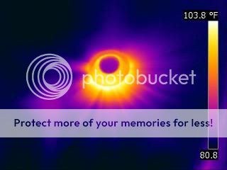

<div class="post-metadata">
**Author:** ![dandersen](https://sea2.discourse-cdn.com/internachi/user_avatar/forum.nachi.org/dandersen/32/59398_2.png) [@dandersen](https://forum.nachi.org/u/dandersen)\
**Post date:** [July 31, 2010, 3:25pm UTC](https://forum.nachi.org/t/are-whole-house-fans-dangerous/51434/10 "2010-07-31T15:25:42Z")
</div>
> 1. Is the attic adequately vented … not just for the excess moisture, but to expel 1200 to 2000 CFM?
If not, the fan will overheat and shut down.
> 1. Creating a negative pressure inside the house draws in outside moisture and pollutants. (Crawlspace environments are actually sucked into the living space).
It doesn’t draw it in and leave it there. It keeps on going right out the fan…
> 1. Imagine a small fire starting in the home while the fan is on and the family is sleeping. Will the fan draw smoke past the smoke detection system too quickly to be detected while drawing more air for the flames?
Smoke evacuation may save lives.
> 1. When they are off, they represent a penetration in the thermal boundary of the home and contribute to air leakage.
Yes they do, but mostly in the winter, not in the summer.
Cold air does not “rise”. As you know; there must be a pressure differential across a building opening to leak.
They should be sealed and insulated during the off season.
Your point about the smoke detector exists in most houses, even without the fan installed.
![](https://global.discourse-cdn.com/internachi/original/4X/c/4/1/c41726fa43ed97f41c31b24e450eeb3d22c23d0c.jpeg)

**Author:** ![ldapkus](https://sea2.discourse-cdn.com/internachi/user_avatar/forum.nachi.org/ldapkus/32/58272_2.png) [@ldapkus](https://forum.nachi.org/u/ldapkus)\
**Post date:** [July 31, 2010, 11:21pm UTC](https://forum.nachi.org/t/are-whole-house-fans-dangerous/51434/14 "2010-07-31T23:21:32Z")
</div>
> [@mlarson](#):
> The cable ran through a small tube.
> Any air bypass was minimal.
I’ve seen the same set up and a thermal scan indicated minimal air loss under negative pressure.
**Author:** ![jbushart](https://avatars.discourse-cdn.com/v4/letter/j/919ad9/32.png) [@jbushart](https://forum.nachi.org/u/jbushart)\
**Post date:** [August 1, 2010, 12:20am UTC](https://forum.nachi.org/t/are-whole-house-fans-dangerous/51434/15 "2010-08-01T00:20:48Z")
</div>
Thermal scans do not and can not measure amounts of air leakage.
Since air leakage accounts for 5% to 40% of space-conditioning loss and is usually found to be many small sources of leaks combining for the total AER, there is no such thing as an insignificant air leak. Sometimes, under certain conditions, air leaks can be seen by IR cameras…but they can never be measured by them.
