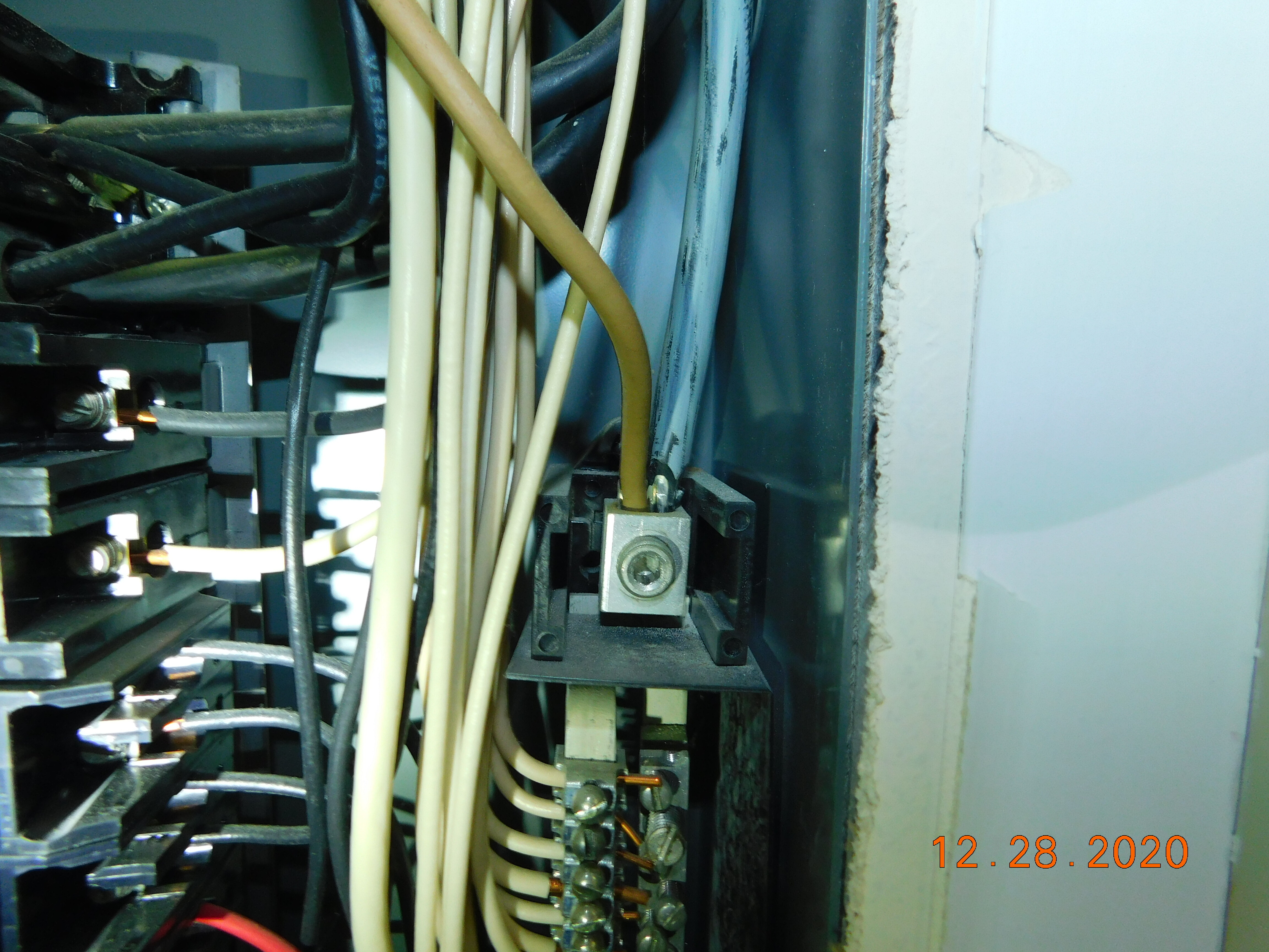

Arrester inside sub panel
I am planning on calling this installation out. This is installed inside a condo subpanel, Main disconnect is located on the exterior.
Buyers agent sent a picture to some electrician and he say’s it’s ok. Citing code 230.82 Equipment Connected to the Supply Side of Service Disconnect
Which i believe he or she is citing the wrong code.
So just want to be sure this is not the proper installation of the arrester.
Thanks
Hi Neil. I don’t think Bryant breakers were designed/approved for double taps. Tell 'em the electrician should visit & put it in writing with his lic number, there’s nothing else to say. :cowboy_hat_face:

230.82 does not apply because it’s a subpanel. The SPD should be on its own 2-pole breaker in that panel and ideally outside of the enclosure. Those terminals are not rated for 2 conductors, especially of different gauge like that.

The way i am reading ( and Larry i have that language pulled up) it as Only the following equipment shall be permitted to be connected to the supply side of the service disconnecting means:
It is not connected on the supply side of the service disconnecting means It’s installed after the disconnect. That is why i am questioning this install.

SPD can be installed on the load side (downstream) of the main disconnect. That’s where they’re usually installed. The only issue is “how” it’s installed, not where. Of course, it’s worth pointing out that any branch circuit breakers (I’m assuming there are none) in the service (main) panel won’t have any surge protection.
Too my knowledge and that of my master electrician, this is wrong #1 where it is installed and #2 there is no appropriate double tap especially on the legs coming into any panel. An additional connection needs to be added. And adding to what Simon advised two different conductors sized is not good. Looking at the wires again, the assertor appears to have copper and the feed lines are aluminum. What could possibly go wrong with that?

Both are Aluminum
I would not go by anything she said he said… if it’s not in writing, it did not happen. You can, if you want, ask the electrician how he thinks 230.82 applies to a subpanel :slight_smile: The agents have no say in this, only your report does.

The electrician should be able to tell that this isn’t the service equipment by the lack of a service disconnect in the panel.
According to the 2nd photo the conductors are type RHW which likely makes them tin-coated copper not aluminum.
I don’t know for sure if he is, BA said he’s an electrician, again I’m not sure what she sent him as far as pictures or what he saw from the pictures. He should not be saying anything as in anything is fine if he didn’t see it first hand with his own eye’s
I think that it’s safe to say that if he had seen a photo similar to photo #2 he could determine that this is incorrect.
Ok- since I am not there I will take that as fact. I have never seen an arrestor or surge protector with aluminums wires.
