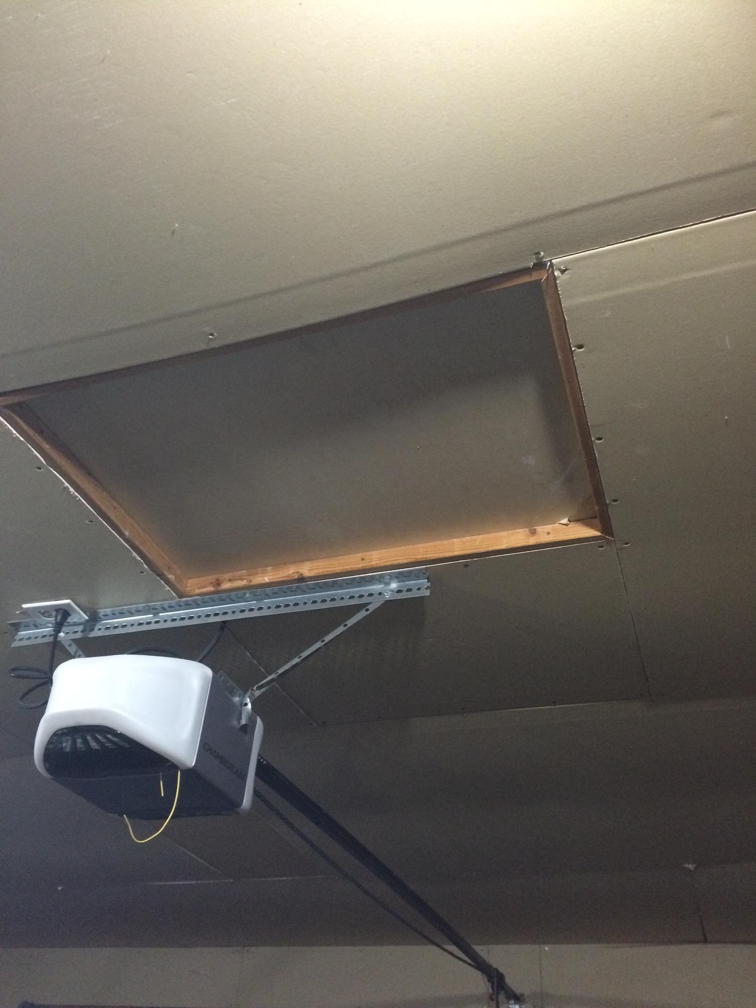

Here is the attic access located in the garage of this home. It measures 23"
X 32" and is easily accessible. The garage door was close to it, but did not interfere with the access. I would consider this acceptable.
However, the drywall installation is a different story…

doesn’t look like You’ll need the hatch much longer…
Looks like unfinished new construction.

The door opener is in the way, but how picky should one get? In my area, the attic access is called a Attic Scuttle. Mine is in the garage also. So it doesn’t need insulation on the backside. Non heated area. I do see the drywall is installed with the seams un taped and not mudded, but this is what the big builders are doing to save $. I have built new homes since 2005, and always finished the garages complete. I even painted them.
