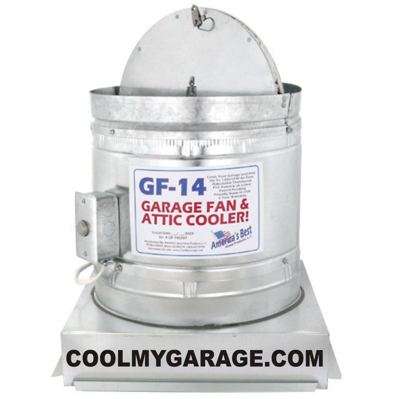

There is a product that meets all codes nationwide in regards to fire rating for garage ventilation available from America’s Best Home Products.
On line google garge fan or go to [coolmygarage.com](http://coolmygarage.com) 😃 for details.
I have inspected alot of them in homes here in AZ and the company that makes them is in Tempe AZ. The one in the picture is nothing more than a gable fan in the ceiling and would act as a chimminey. Here is what the GF-14 garage Fan looks like. It has a fire damper that closes in case of fire keeping the fire our of the attic.

It would still need to be ducted to the exterior

If it had a fire damper would it not be ok? Other the many reason you would not want this venting into the attic, fumes, dust and so on.
<div class="post-metadata">
**Post date:** [August 18, 2011, 11:42pm UTC](https://forum.nachi.org/t/attic-fan-in-garage-ceiling/2042/8 "2011-08-18T23:42:05Z")
</div>
Installing the exhaust fan in the exterior wall of the garage to the exterior would solve many headaches. :)😃

Fire is certainly a major concern but what about a running car… carbon-monoxide through the house…someone could go to sleep and not wake up! Vent to the exterior or write it up for several safety reasons.
