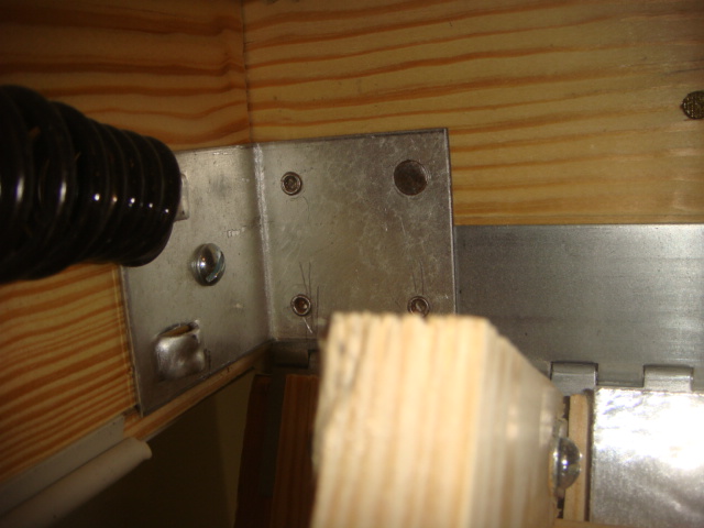

Are all of the nail holes supposed to be utilized with 16d nails? I see this quite often where not all are used. This is a brand new home.
jumped the gun. they are filled.
:roll:I think those are rivets???
look like 10d?
Don’t forget those pivot plates.
http://www.memphisfoldingstairs.com/pdf/MFSWEBFORMAT-0101.pdf
I see three rivets and a roofing nail. Compare the head of the roofing nail with the head of the 16d vinyl-coated checkerhead sinker visible in the upper right hand corner. I’d call that one for fastener replacement by a qualified contractor.
